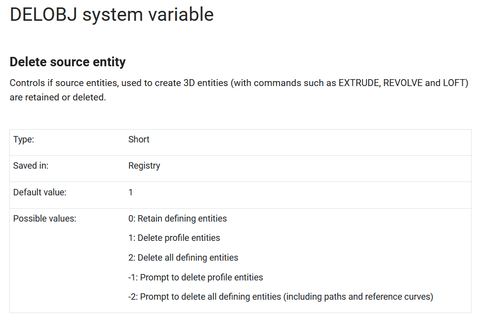

just wanted to mention the system variable DELOBJ in case you are not aware of it…
It controls if source entities, used to create 3D entities (with commands such as EXTRUDE, REVOLVE and LOFT) are retained or deleted.
