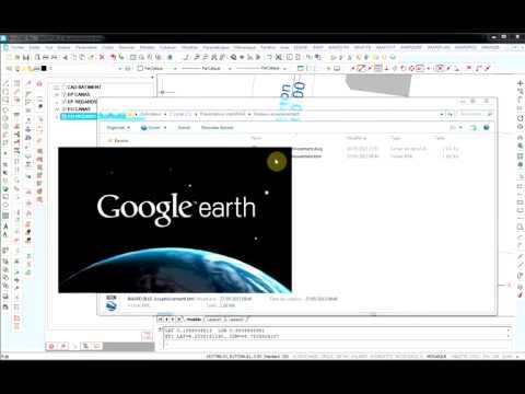

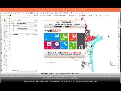

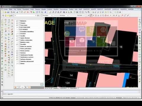

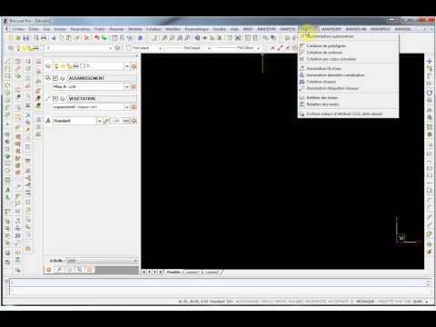

Hi Dominik,There is also intelliMAP, in French version, wich provides you lots of GIS functionnalities and topographical drawing functions.Internet site: www.intellimap.frSeveral videos concerning this product:Etienne MOROTechnoGIS0
