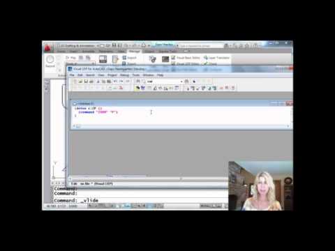

There are also YouTube tutorials on lisp. If you want an absolute beginner level video, try
https://www.youtube.com/watch?v=G_QY_iY6gB0
