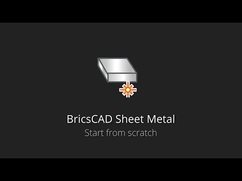

Hello dadd,
Likely you call SmBendCreate command while you should SmFlangeBase, SmFlangeEdge or SmFlangeBend. Study the tutorials in
https://www.youtube.com/watch?v=zPTzEKV5IrI&list=PLONdQc9bizseq1btwlPc3j6u4jSK7hSEg . The one you need is "Design sheet metal parts from scratch", while SmBendCreate is for "Rework an imported part".
Watch Bricsys channel for updates.
