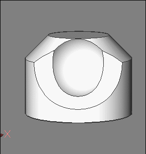

Seems DAE export is some disturbed! (in Meters)
Must be scaled by *1 000 inside SKetchUP (who is in Meters)
And some facetts are not filled! (Top, rose-window and some on front face)

  • Looks like Sketchup shows Faces from both sides,
    so the top Face may really be missing. Not just being flipped.
    I expected Sketchup to show standard 1-sided Faces only,
    as it creates a 2nd Face when you want a different Material
    for the Back Side.
    So far I never noticed missing Faces from Bricscad in DAE,
    which was the only 3D Export until V19.
    But there might be slight overlapping at both Chamfers
    where they meet at the top Edge, which may confuse meshing.

    The dae is perfect! So seems SketchUp engine import DAE has some problem! ;)
    Here following the same DAE above inside Simlab Lite! No special problem!

    I found the DAE problem! :)
    If i Scale * 1000 before import inside SketchUp all works fine in SKetchup !
    Here i scale *1000 in Meshlab so I suppose if I scale * 1000 in Shape that will be the same!
    The curious is all Shape and SketchUp are both in Unity meters!
    So seems that is the DAE export from Shape who as a little bug of scale 1000! :)
  • edited May 2019
    Verifyed! I must make a Scale * 1000 inside Shape for have the good result in Sketchup!
    Even both programs are in meters!!!
    If you can transmit this DAE bug...
