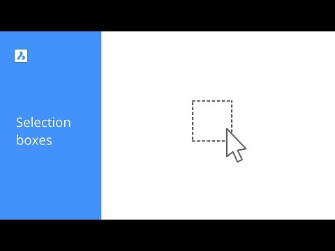

    I don't understand that is well describe for Shape no ?
    https://www.youtube.com/watch?v=h4wMXoQ4Ozw
  • Marquee Selection Right/Left or blue/green works fine here.
