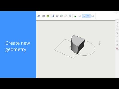

    I was thinking about that Video, but inner Boundaries only ....
    https://www.youtube.com/watch?v=m5M9QQiJces
