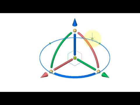

CADMabel: I watched the video and saw how you used the Manipulator to move the triangle. Thank you for waking me up to the possibility of using the Manipulator and using my vision to place the item. I was trying to figure out how to do it with grips and snaps involved and couldn't come up with anything that didn't involve temporary geometry, hence this thread.
The first few times I tried your approach, I could move it to just above or just below the bottom black line. Eventually I zoomed in enough to get the manipulator to finally fall on the line.

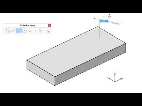

I think You need to get used to working in 3d. With MANIPULATOR I can move, rotate and copy at any point and in any direction. See this:
https://www.youtube.com/watch?v=VWQ6r5AK8fE
https://www.youtube.com/watch?v=ECurprEbqic
https://www.youtube.com/watch?v=HfJVjIZJeT80 -
