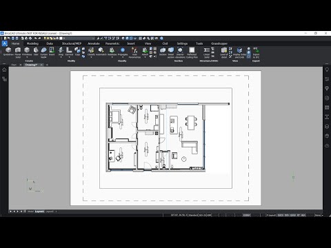

But AFAIK you can choose from any information available in Bricscad
and add it to your table.I think it is described at the end of the Video :
https://www.youtube.com/watch?v=dU2hnxkCmcM&list=PLONdQc9bizsfzuES9MrwxUEH9M4PPfyRm&index=6&t=0s0 -
