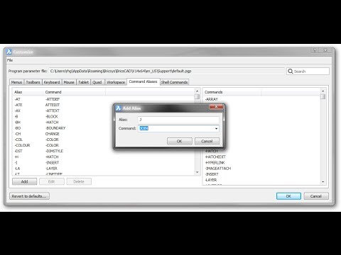

This might help you:
https://www.youtube.com/watch?v=qwcuK6zixHo&ab_channel=BricsysI can confirm that with POINTCLOUDMAXPOINTS set as 20mil the rotation/pan/zoom can be a bit slow. We usually suggest a value around 4mil for a smooth camera transition and good display quality.
