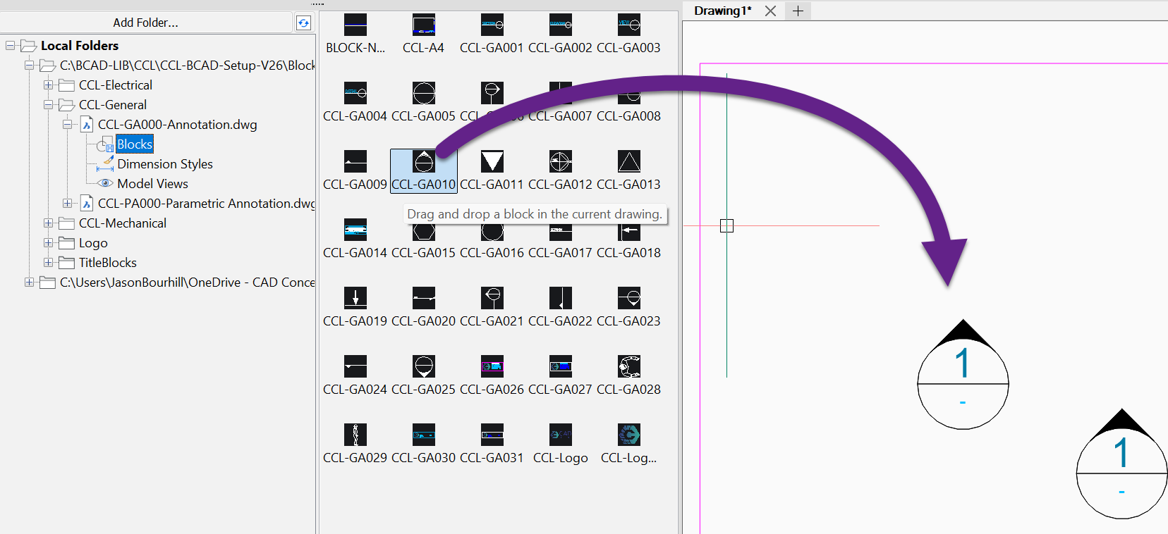

Is there anyway to ignore the prompt to scale and rotate blocks while inserting from the Library?
in 2D Drafting
I have made a user defined folder in my library with some standard everyday blocks that are drawn to the correct size for the projects I work on. When inserting these blocks is there way to skip the 3 prompts for the scales and rotation without having to entre through them each time?

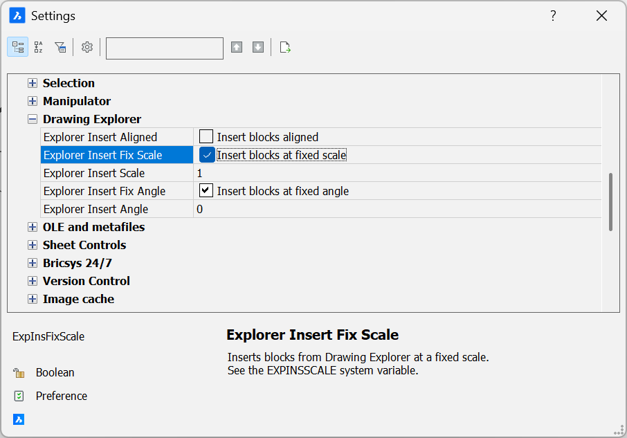

In my older version, I un-check "Specify On-Screen" for Scale and Rotation, and check "Uniform Scale," and it inserts with no prompts other than for a pick point. Those settings are kept until I change them, even after closing and re-starting.
