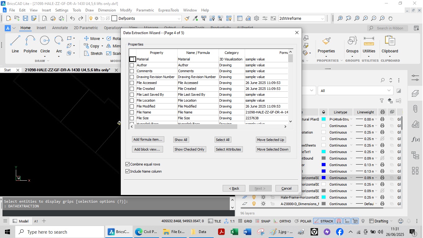

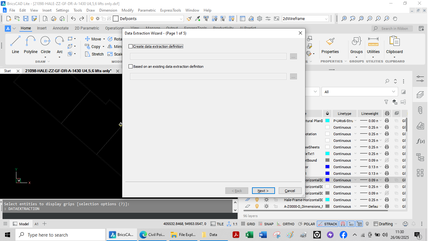

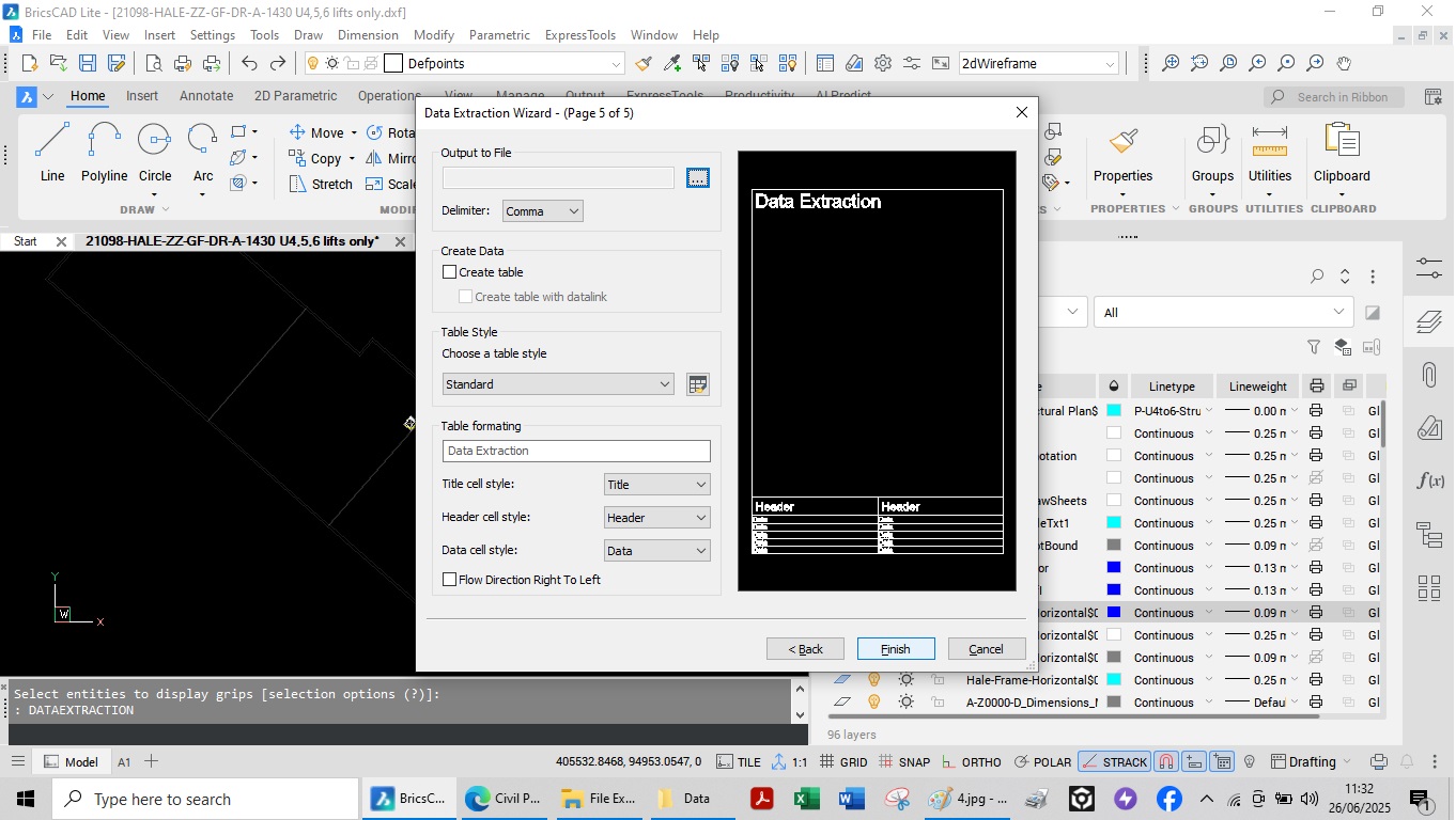

hi where is the "point number, point raw……., etc"?
thanks
0 -

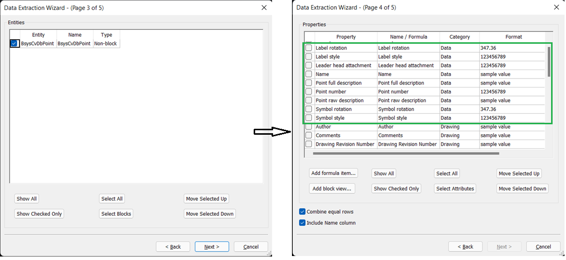

Hi @Zed , there are no Civil point entities on your example. When they are present in the drawing and selected for data extraction, specific properties become availiable.
0 -
From your screen grabs, you look to be using BricsCAD Lite. You need BricsCAD Professional or greater to work with BricsCAD Civilpoints.

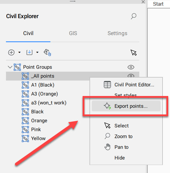

Starting with BricsCAD 25 Professional you now have the option to easily export Civilpoints from a drawing by right clicking on the applicable point group from the Civil Explorer Panel and selecting Export points…
