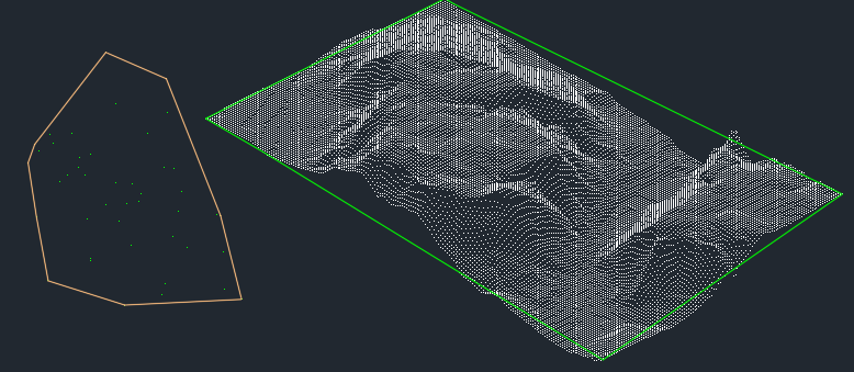

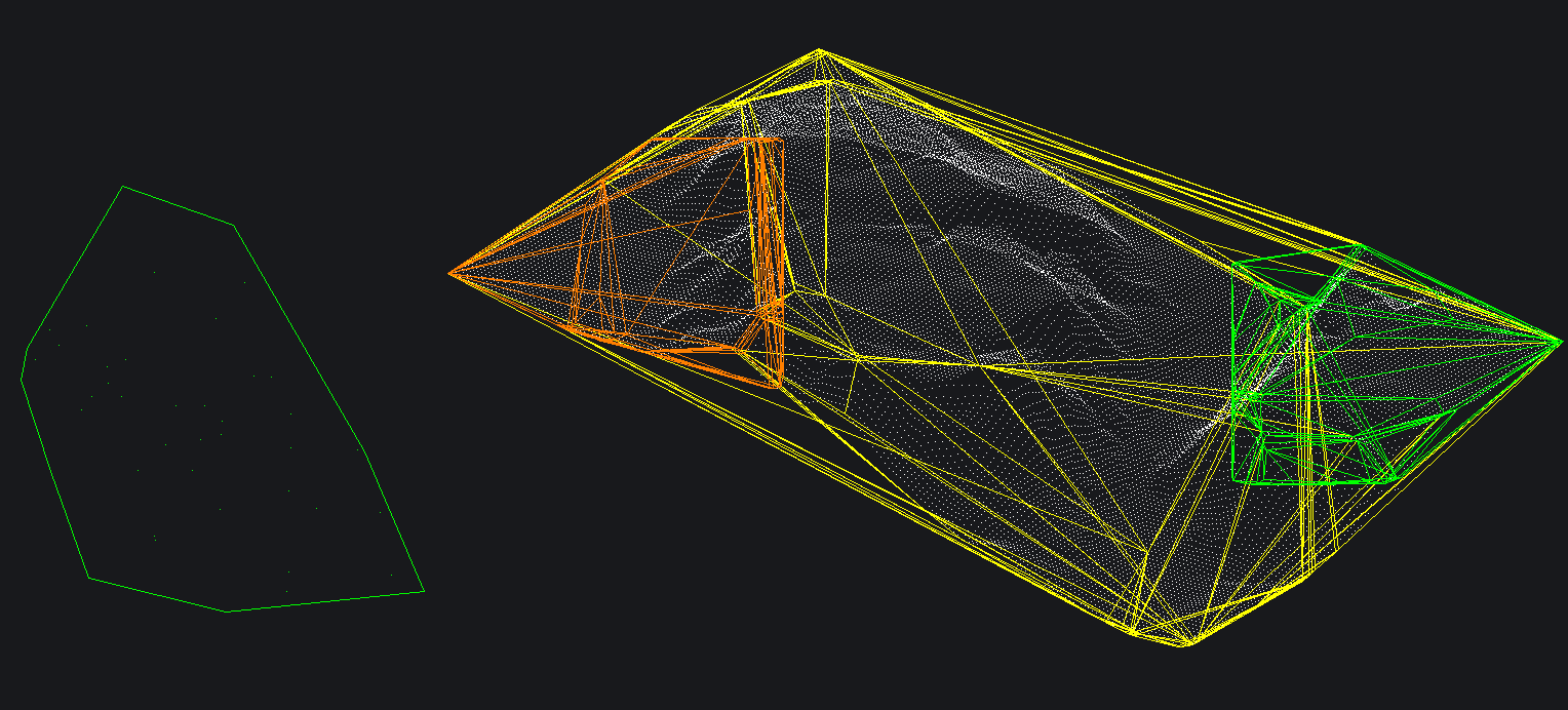

  • Here you find a plugin exposing 2 commands , CONVEXHULL2D and CONVEXHULL3D .

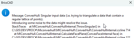

    It is programmed in a "quick and dirty" mode, therefore it might generate errors if the selected points are not accepted by the algorithms…in this case an error message pops up similar to
    The 2D Convex Hull is based on GrahamsScan algorithm and is a polyline, the 3D Convex Hull is based on the MIConvexHull algorithm which is technically an implementation of the QuickHull algorithm and is a mesh(SubDMesh) , You find more information at
    https://designengrlab.github.io/MIConvexHull/
    https://github.com/DesignEngrLab/MIConvexHull
    It is very fast for me …..
    You find attached the plugin with ConvexHull2D3D.dll and MIConvexHull.dll in a ZIP archiv and the test DWG. Save both in a directory and load the ConvexHull2D3D.dll with the NETLOAD command.
    Call the commands at the command line…..

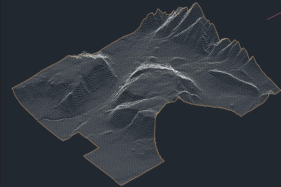

    In the screenshot you see the convex hull (2d, 3d) of different groups of points.
    Attached is also the test file used.

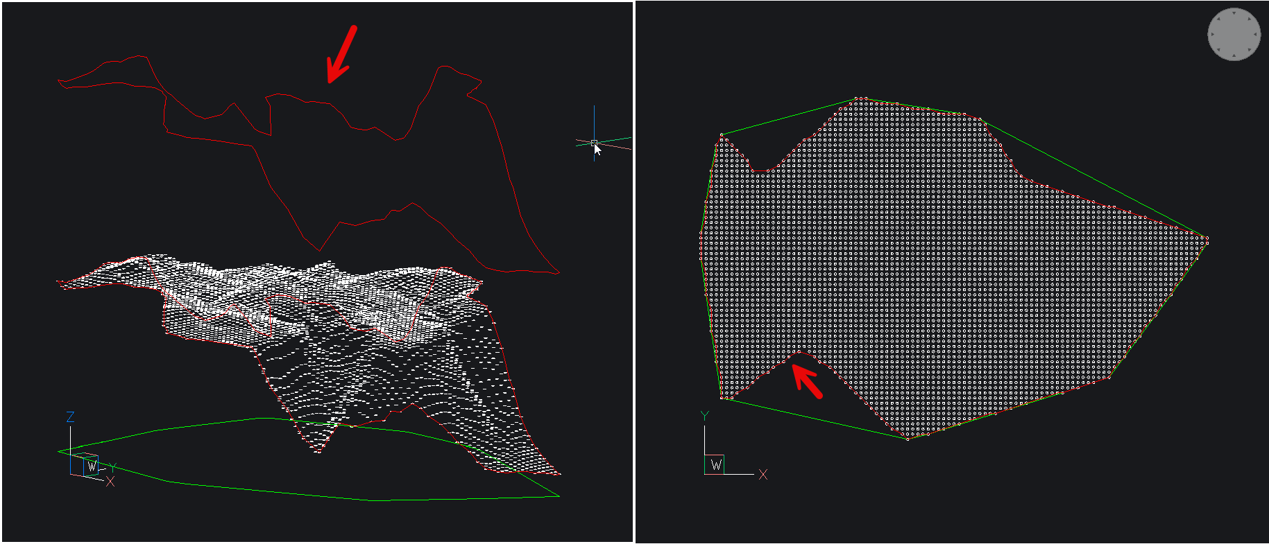

    Having spent way to many years playing with TIN's there is an error in the convex hull shape if you look closely at the image the boundary skips across a large indent, lower left, a true boundary would actually follow this shape.
    One other way is to use the TINS to make an outer shape but its not quick as you need to get rid of long triangles. Make a 3dfaces and so on.
    The main reason for wanting boundary is when comparing to another surface eg Volumes.
  • That’s not an error in convex hull, if you want to pick that up, you’d have to use a concave hull.

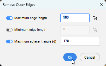

    2. Remove the outer edges thus creating the outer concave hull boundary of the tin surface using the TINEDIT command
    : TINEDIT
    Select TIN surface [selection options (?)]:
    [Add Points/Add Point Groups/Add Breaklines/Add bOundaries/Remove Points/Swap Edge/Point Location/Point Elevation/Add Line/Delete Line/Remove Outer Edges/Minimize Flat Areas/Remove Elevations/SMoothing]: ROE
    Define
    concavity and lengthThreshold in the pop-up window
