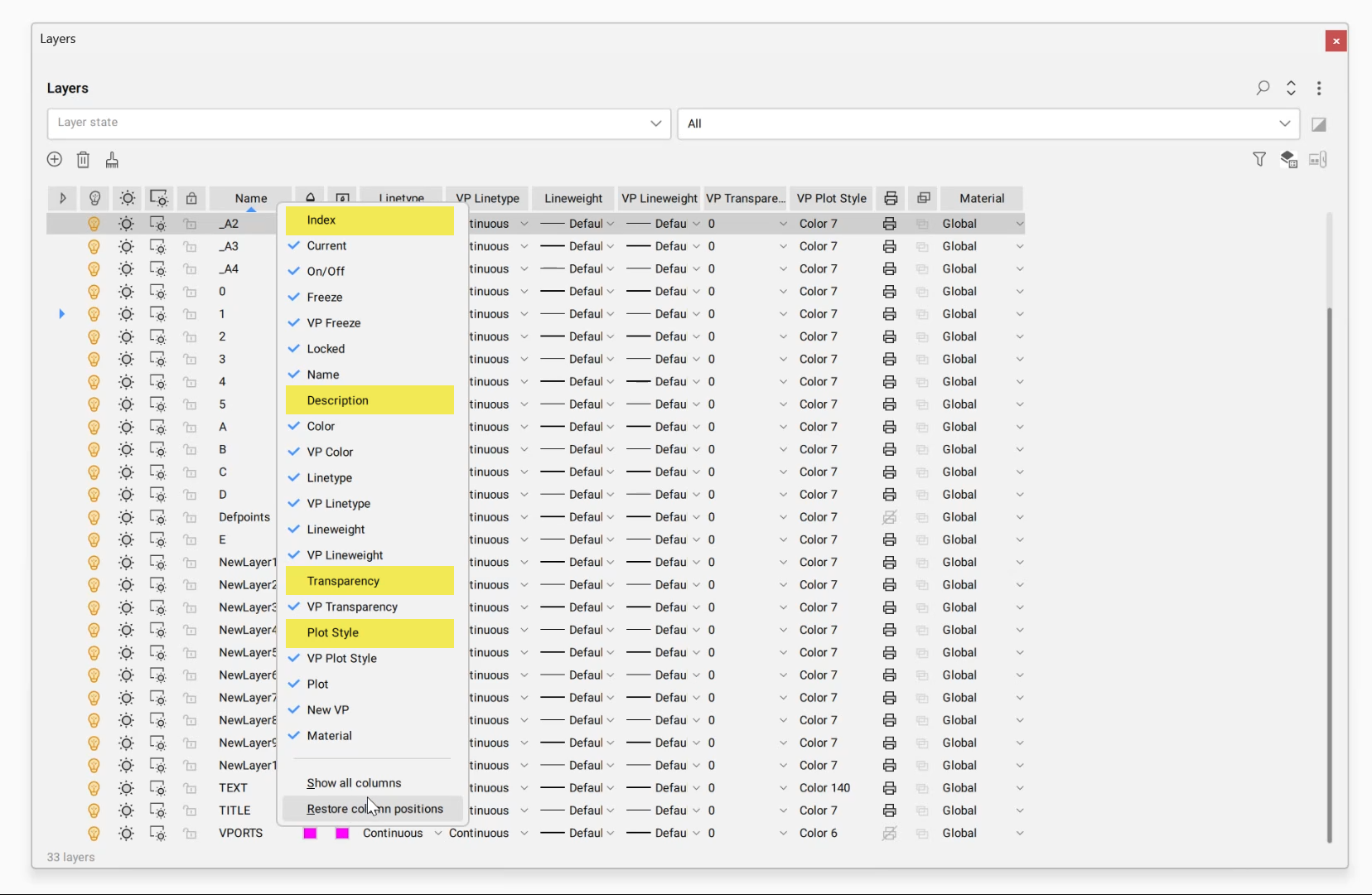

  • Regarding Layer sorting. We had a client report this issue to Bricsys recently (SR 197858).
    From investigation it looks to occur if you turn on additional columns other than the defaults. If you're experiencing this problem, then I would try reverting to displaying just the default columns. To do this you turn off:
    • Index
    • Description
    • Transparency
    • Plot Style
    Following this change, you need to close and restart BricsCAD before sorting will work as expected.
    Jason Bourhill
    CAD Concepts Ltd
    cadconcepts.co.nz
  • I would add that in addition to the four options indicated by Jason turned off, you need also to have all other options turned on (exactly as shown on his screenshot).
