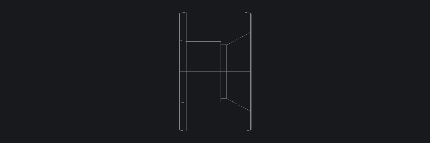

the code works very good apart from the fact that the .bmp show the block in "2dWireframe" visual style even though the drawing is set to "Modeling" visual style.
can someone help me make this code create the .bmp in "Modeling" visual style?
PVC REDUCING BUSHING 63x32 SW_3d.bmp is the resault in "2dWireframe" visual style.
