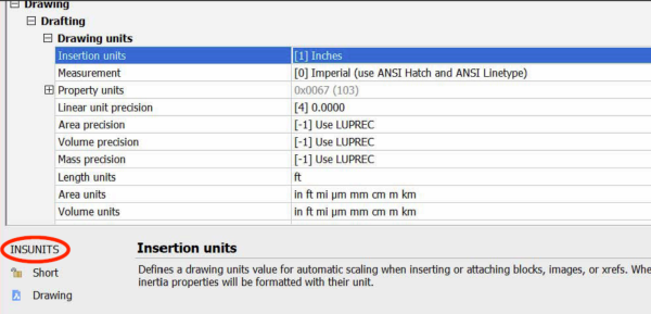

go to DSETTINGS,
type in the searchbox INSUNITS and see what are the options there and what is their code.

The Settings dialog tells you, in the lower left, which variable controls each setting.
It also tells you where the setting is saved. For any setting that's saved in the Drawing file, you might not need a (setvar "variablename" value) line in the on_doc_load.lsp file, since the setting is saved in the Template. And everything you can set in the Drawing Explorer is saved in the Template.
To save a template, use the Save as... command, with Drawing Template (*.dwt) in the Save as type field. Templates should be saved in the Templates folder, which is opened by the New command.
