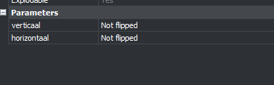

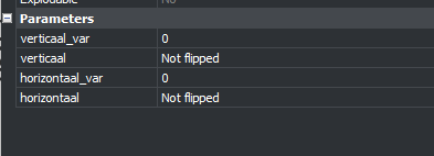

When I copy a simple block with 2 flip possibilities (verticaal and horizontaal). In the copied block i get extra parameters.
Can someone please tell me how this is possible and what i'm doing wrong.

_DYN_draairichting,it has 2 parameters a a distance and a flip parameter,If I copy it I do not get any other parameters.Edit the block, BricsCAD performs a Block Convert, to convert a dynamic block to a parametric block.it looks like it is an AutoCad block.maybe recreating it with parameters is a solutionuse PARAMETRICFLIP

insert the dwg as a block and then copy the block.0
