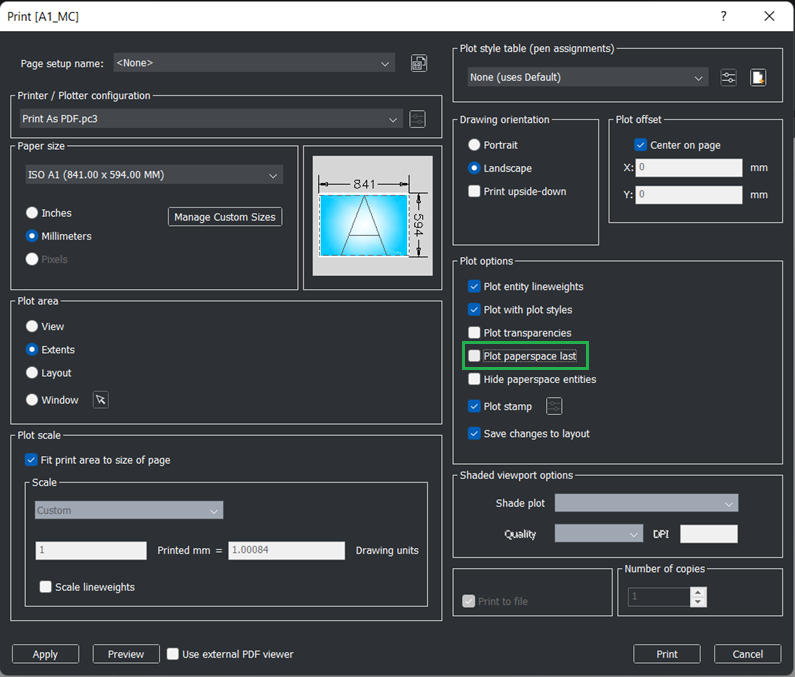

Try to turn Off option "Plot paperspace last" in Print or Page setup dialog - paper space entities will be printed first, then model space entities.

Lyubov Osina said:Try to turn Off option "Plot paperspace last" in Print or Page setup dialog - paper space entities will be printed first, then model space entities.
WOW, thank you Lyubov, never thought about this option!0 -

Each Layout has its own page setup. You checked "Plot paperspace last" for sit, but not for UZD.
You can copy the page setup from one Layout to another, in the Page Setups section of the Drawing Explorer.
