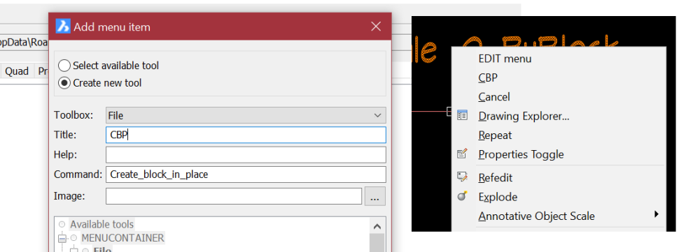

How can command be added to context menu, when it's a custom one.
I have already loaded a LISP file via APPLOAD.
Not sure if the LISP routine works in BricsCAD but will deal with that next (it works in AutoCAD).
I figured out how to add standard commands to context menu:
Type CUSTOMIZE or CUI. In Menu tab, go to Context menus. Right click, Insert item, select Create new tool for example, fill in details.

    Yes, that's how you add a custom command to a context menu. Are you clear on the different types of context menus, e.g. Command, Default, and Edit?
    If you post a lisp function here, people (not me) can tell you what needs to be changed, if anything.
  • Thanks Anthony, it's Default or Edit, but this is a custom command, not one already in there, so how do I create the command to shown in context menu.

  • Anthony Apostolaros
    edited May 2025
    That custom command works for me. I added it to my Default and Edit context menus, and that works too.
  • OK thanks Anthony, at least I know how to add now.
