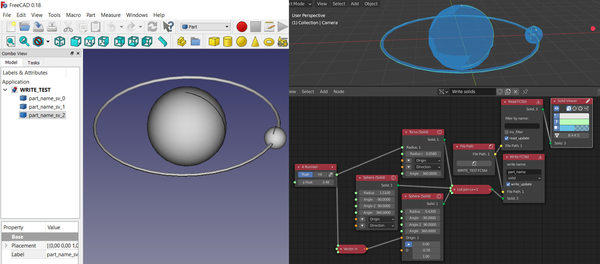

I found that there exists interoperability between FreeCAD and Blender, thanks to Python and Sverchok (External Nodes for visual programming, similar to DynamoBIM). And, until I know, BricsCAD supports Python for BIM things… maybe this is the way? … But How?
1 -
Here a sample:
