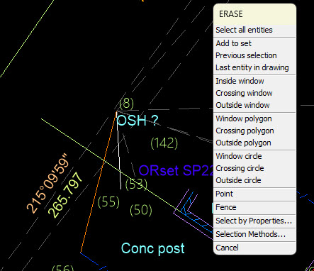

In v18 when I invoke a command a dialogue box with other commands pops up.
In v25 it doesn't. See below - ERASE option in V18

There doesn't appear to be a palette hidden off screen.
I have pressed every F key and again to change back to no avail. Looked along bottom of screen at the icons there and done same.
it's same for any other command - COPY etc
I see the command line has extras in 25 over 18 and suspect there's a toggle to make this work.

try the PROMPTMENU sysvar
1 -
many thanks. Will give that a go tomorrow.
0 -
well that fixed that.
