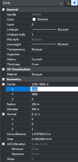

Is it possible to go to next line when editing fields and then pressing Enter. For example, enter X coordinate, press Enter and go to Y coordinate.

If you want to change a circle X & Y use Move, pick center point, then type new x,y. 123.45,678.98 and circle will move.

OK thanks, but the question asked something different

Pressing TAB, will take you to the next line in most sections of the Properties Palette.

Thanks David, this helps.
Would have been useful to have a setting so that Enter can be used since in keyboard number pad
