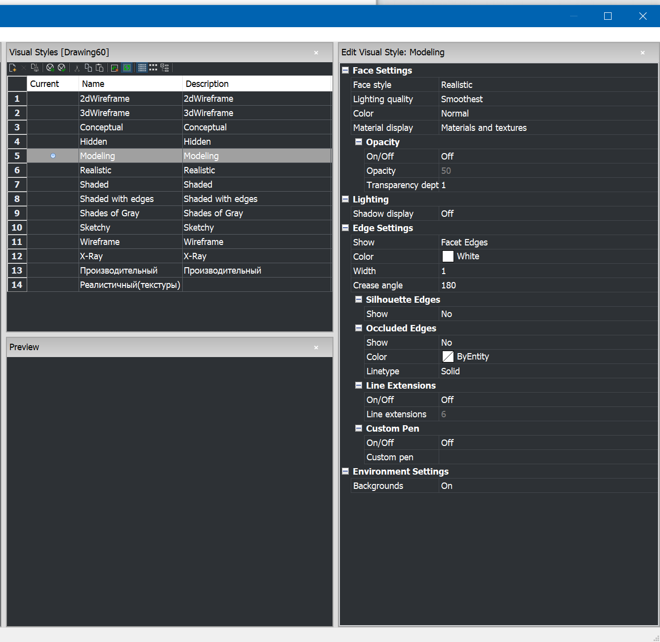

Have some issues with visual display of edges, faces and highlights.
  1. Hidden edges are partially displayed, although they are disabled in the visual style
  2. Faces are not displayed correctly (saw-like effect)
  3. Selection "flickers"
Tell me which way to look, nothing in the settings has helped so far
Setting of visual style:
Video with the problem is attached

    Is the Geometry far from Bricscad Origin ?
    (Or some lost parts far away)
    Do you use the latest driver ?
    (Directly from the Nvidia Website. Drivers from hardware Vendors like e.g. Dell or offered by Microsoft Update are often outdated or limited and can cause propblems with demanding Software)
    Beside you could try to switch through GLSWAPMODE Setting options in Bricscad.
    (Default is [2], I use [0] ?)
  • Strangely enough, copying the entities to a new file helped. thx!
