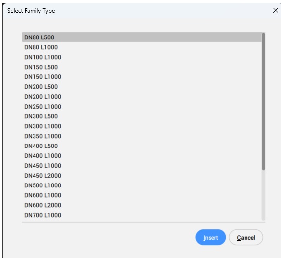

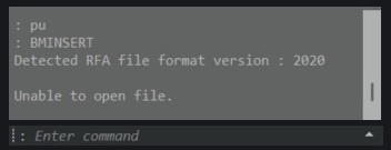

I would like to know if it is possible to insert an .rfa block into BricsCAD BIM when it has multiple selection parameters. For example, when I insert the .rfa block (with the BMINSERT command), I have several options to choose from (see image1.jpg). If I select the default option (DN80 L500), the block is inserted successfully. However, if I choose another option, the block is not inserted and I get the error message shown in image2.jpg
Does anyone know how to solve this without having Revit?

As I know, some of the Revit families are not supported yet in BricsCAD, i.e. parametric .rfa files.
