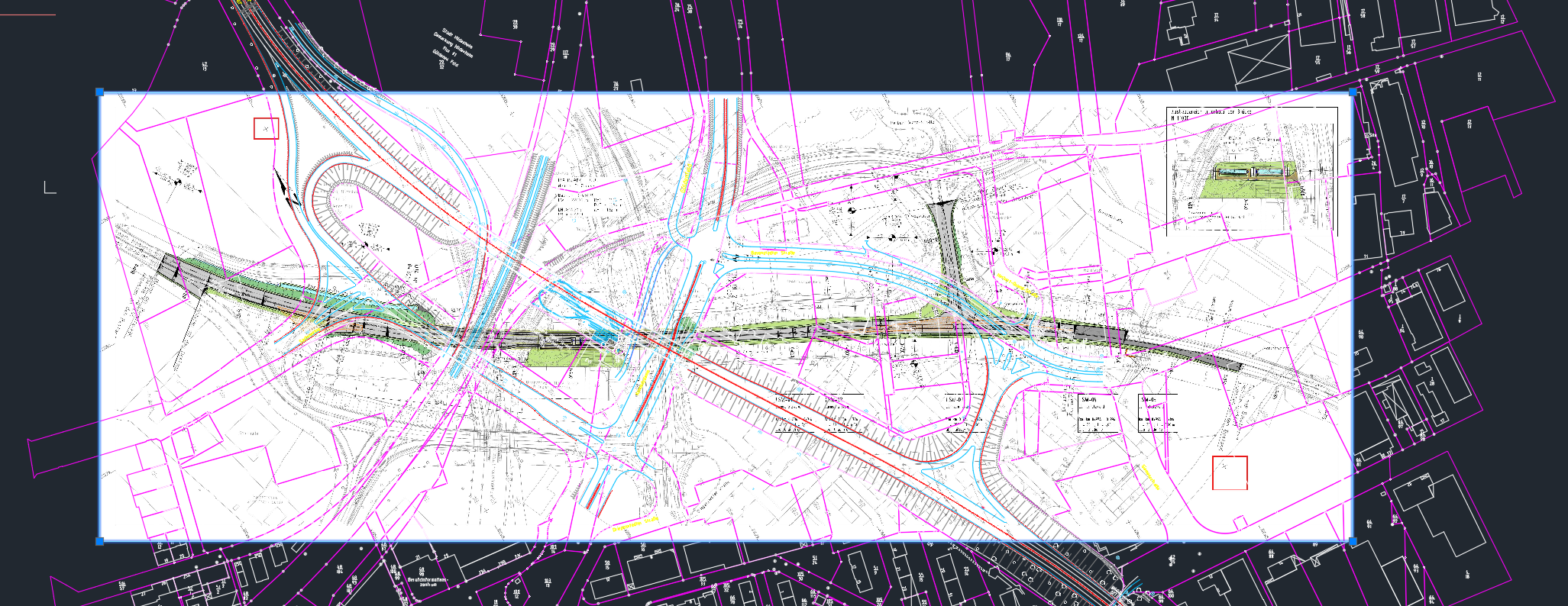

    First you have a drawing:
    Second you attach an image, for example of an old Projekt in this area:
    The image is in the project area but does not align with the drawing

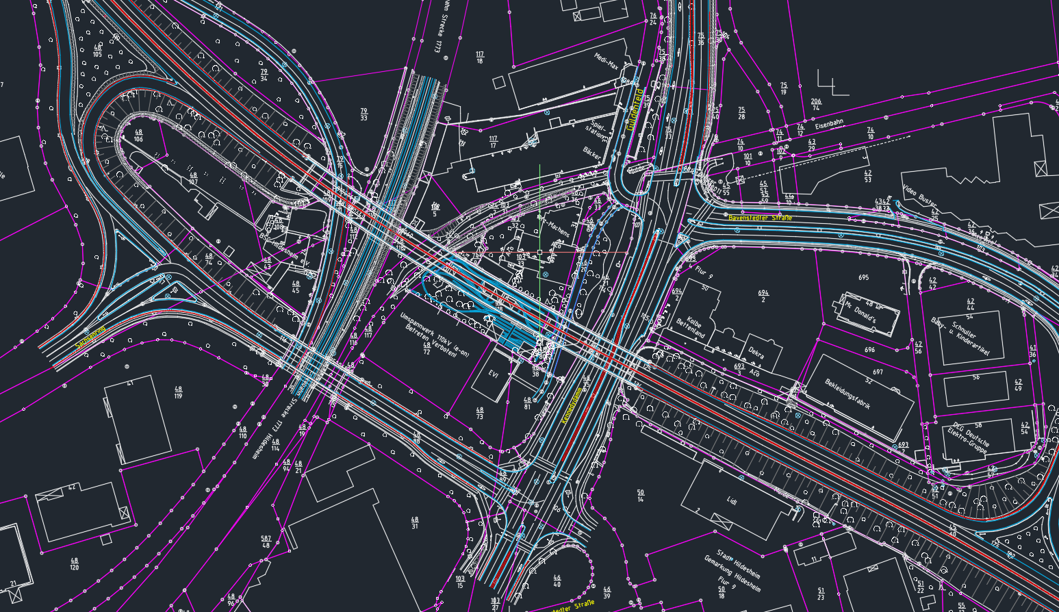

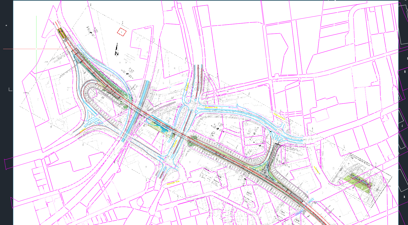

    third you use A-Cad Raster design to match points on the image an the drawing:
    Click ok ans the image is set
