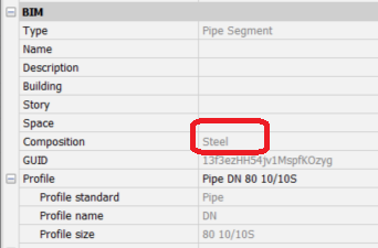

Does anyone know how to change the material of a pipe segment created from BIM Profiles > Piping > Pipe?
By default, it appears as Steel, but in some cases — not all — I would like to change it to another type of composition. However, the Properties panel doesn’t allow me to make the change.

  • Looks like you need to select your Pipe Segments, go to BIM > Attach Composition and select another Composition.
    (Initially I tried selecting my Pipe and dragging another Material from the Composition Panel - but after that my Pipe disappeared)
    With attach Composition, I could exchange the Steel of my Pipes with a Gold Composition ….

    Thank you very much for the help, it worked!!!
