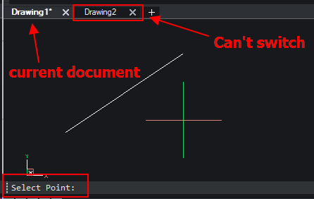

It is not possible to switch documents during user operations.
The "LINE" command allows you to switch documents.(Switching documents will end the command.)
I would like the custom command to be the same as the "LINE" command.
Is there a way to switch documents with a custom command, just like with the "LINE" command?

    I tried "CommandFlags.Session", but it didn't solve the problem.
        <CommandMethod("test", CommandFlags.Session)>
    Public Shared Sub test()
    Using docLock As DocumentLock = Bricscad.ApplicationServices.Application.DocumentManager.MdiActiveDocument.LockDocument()
    Dim editor As Editor = Application.DocumentManager.MdiActiveDocument.Editor
    Dim pop As New PromptPointOptions("Select Point")
    Application.ShowAlertDialog(editor.GetPoint(pop).ToString)
    End Using
    End Sub
    The problem is occurring in BricsCAD V25.
    →BricsCAD version:V25.1.06
    As a side note, in V19, custom commands worked the same as the "LINE" command.

    STEP1: Execute the "AddDocumentToBeDeactivated" command.
    STEP2: Execute the "test" command.
    STEP3: I try to switch drawings during the "GetPoint" operation.
    RESULT: The drawing does not switch. The "DocumentToBeDeactivated" event does not occur.
    It looks like drawing switching is disabled. Is there a way to enable drawing switching?
    I'm really in trouble.
    Do you have any information?
