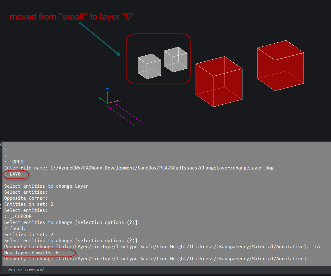

  • This line of LISP worked for me on a test drawing. Potentially it is something to do with the entities you're trying to work with.
    I would try separating the selection set out from the command, as it will make it easier to see where the problem is coming from. It also allows you to employ some error checking to check that you have in fact created a selection set to work with.

    Thank you, Jason, for fast respond!
    Problem solved: selection set was altered in loaded BRX app.
    As in bare bone Bcad both yours and mine commands works fine.
    Thank you for support!
