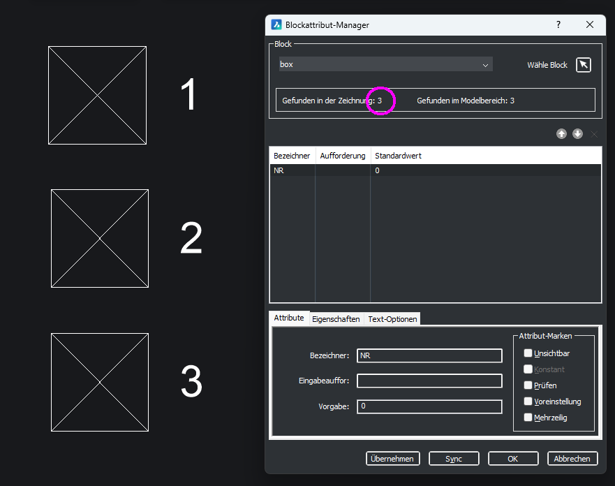

If parameters of parametric blocks are changed, their attributes can no longer be edited with the Block Attribute Manager.
For example, I inserted the parametric block "box" three times. In Block Attribute Manager it is displayed correctly at first:

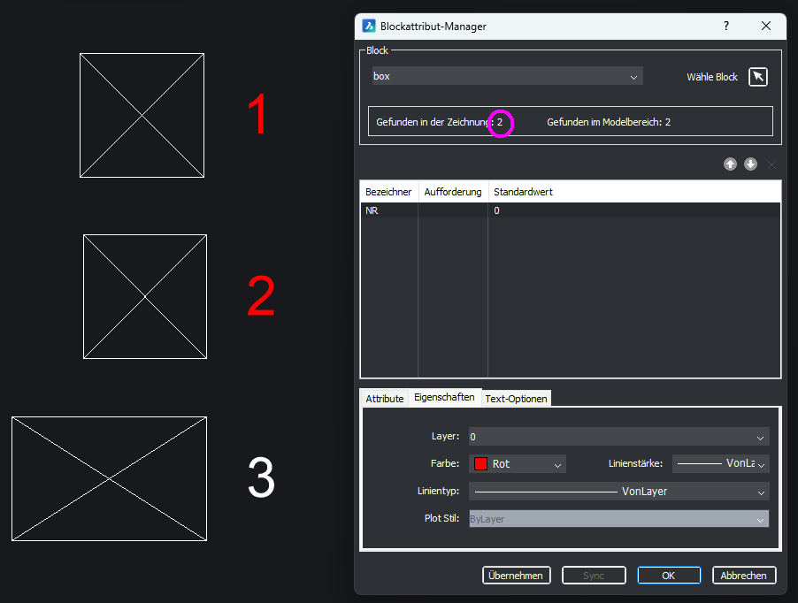

Then I changed the parameter of the length of box 3. Now the Block Attribute Manager only shows two blocks. Changing the properties of the attributes, for example, the color to red, and click Sync, this change will not be applied on box 3.
