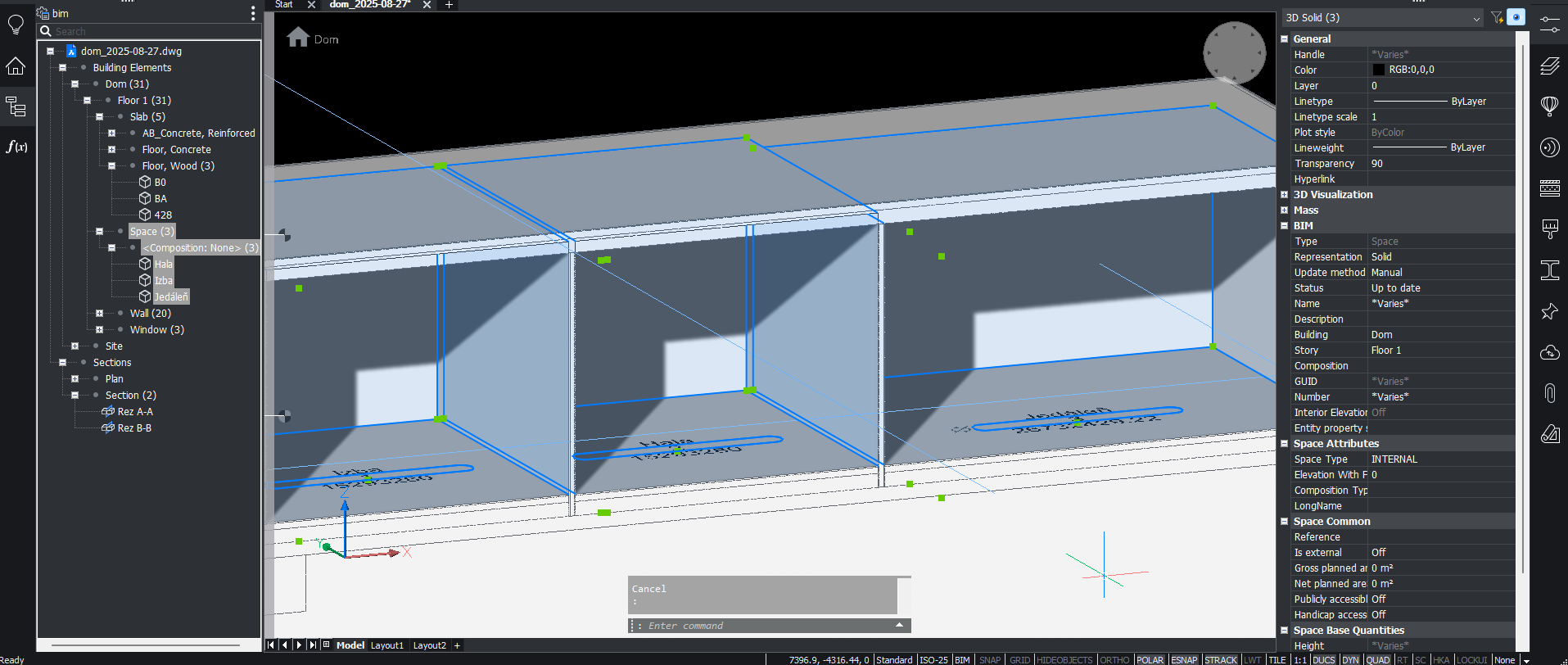

Hello,
I am testing to model some specific things. I found out that 2 of 3 spaces have bad height - they are higher than the bottom of the slab. Any ideas how to fix it? Do I need to recreate the spaces?
Thank you.
0
Comments
Hello.
If the 3D geometry used to generate the spaces was changed, then the spaces need to be updated.
You could experiment with the BIMUPDATESPACE command.
0 -
Hi. It did not work. I had to delete those spaces and to assign new spaces. It took just few seconds to do that ;)
