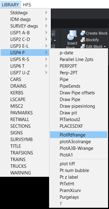

    " explain it to my boss." That can be a big step, I can only comment on doing this for over 40 years. One of my recent projects was manually could take up to 3 hours, same task now is 2 minutes. Yes I got paid for it.
    Have a look at this as where I used to work some 130 lisps behind this menu.
    happy for you to show your boss the DOC, most are free some cheap like a cup of coffee as I have to set up for your dwg.

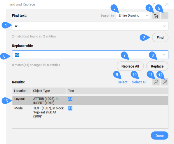

    The picture of the Find and Replace dialog in the Help Center does show a "Replace All" button. Maybe that doesn't work when you're searching for texts inside blocks? I've never done that.

  • Find and replace all should work on all block attributes that have the searched text in an attribute field.
    Depending on which version you have you may need to do a search first which will then list all occurrences of that text and if you then do a replace all then it should replace it across all blocks in that drawing as @Anthony Apostolaros example showed.
