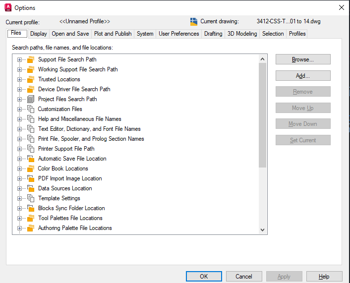

For autocad , i need to set the symbol location through options(as showing diagram below).
I just wondering how to do this at BricsCad , as i going through the BricsCad tutorial , i need create the block for each symbol and manually select the points.

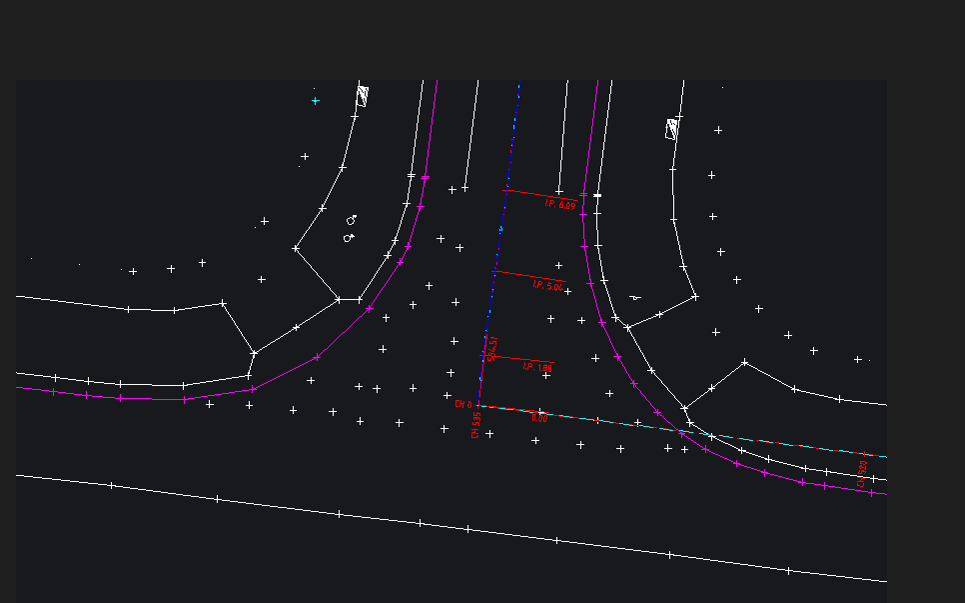

    This is what you should get. Note the telecom pits, water meters etc
