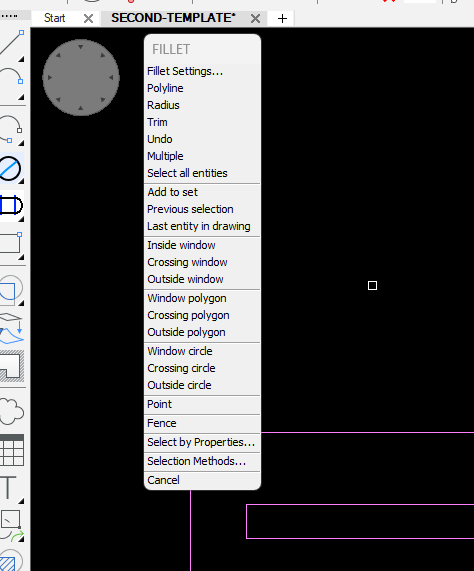

Since installing a recent version (25.2.07) I have been getting annoying popups in the corner of the graphics area - screen grab attached. They serve no useful purpose for me, and just distract me from the job in hand. What are they called and where is the setting to control them, and hopefully, switch them off?

  • I think it's PROMPTMENU 0
  • Anthony Apostolaros
    edited October 2025
    Keith, your screen shot shows the very large prompt menu that pops up during selection (only if you use post-selection rather than pre-selection). If you want to get rid of those large prompt menus, but keep the much smaller prompt menus that pop up during commands after selection is finished, then keep PROMPTMENU on but set PROMPTMENUFLAGS = 2.
  • Thanks for the info - it's one of those problems where if you don't know what something is called you don't know where to look for information, and there are a lot of variables to search through. Both set to 0, and the pesky things have gone away - I don't want this sort of nonsense on screen - and I'm pretty sure I don't need it, which is not the same thing.
