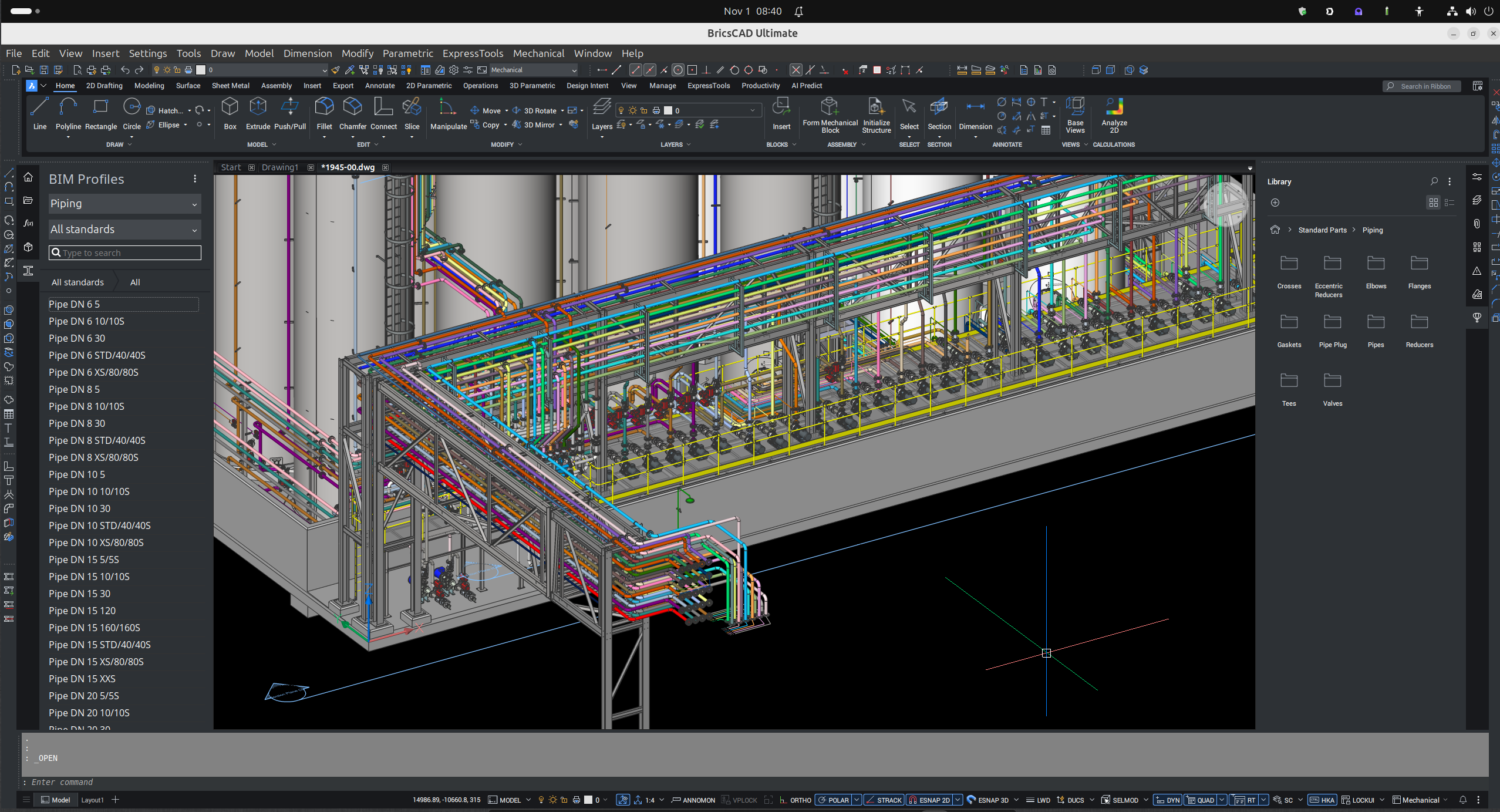

I work in the Process Industry and use Bricscad Ultimate with Communicator, here is my set-up:
Mechanical module.
Side Panels- Mechanical Browser, BIM Profiles, BIM Project Browser, Library and all the default ones.
Toolbars- BIM Connect, BIM Structural, 3d Constraints, Inquiry, Entity snaps
All the standard valve, flange parts are available to drag and drop from the Library side panel under Standard Parts-Piping.
For pipework I use the side BIM Profiles, domain-Piping. The BIM Connect toolbar is used extensively, specifically the Flow Connect command, this joins pipework together, ie it adds elbows, reducers, crosses etc.
There isn't much documentation for piping other than from V22 videos, I've had to figure it out via trial and error over the last 8 years using BC. But one thing I have noted I am considerably faster producing drawings and assemblies than my colleagues using Autodesk Inventor, and the quality of work is better in my opinion. I just wish BC was less buggy….
Hope this helps…

I have attached a screenshot of my mechanical workspace, it’s nothing special, just the addition of a few toolbars.
Happy to help.

Thanks for the screen shot, at least this will give me a good solid starting point. I currently still work full time using Solid Edge, so this will be a gradual part-time intro to BC for me over the next few months as I transition into retirement in 2026.
