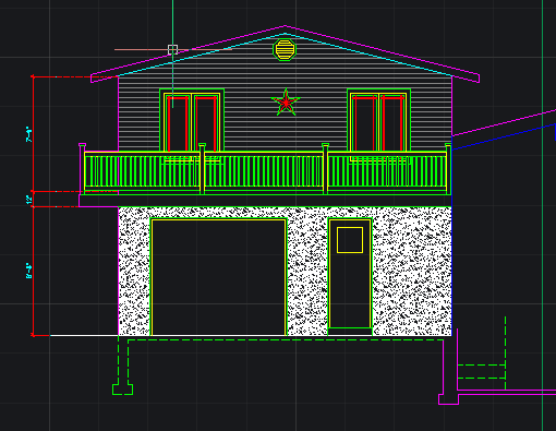

problems with custom hatch pattern created in Autocad
Can anyone explain why my old autocad custom hatches aren't working in BricsCad? Alternately does anyone know where I can get hatch patterns for stone walls that will work?
Comments
  • have you looked at Hatch origin point, Ar-conc is one we used all the time and it suffers from X & Y being big co-ordinates, resetting the origin fixes it.
