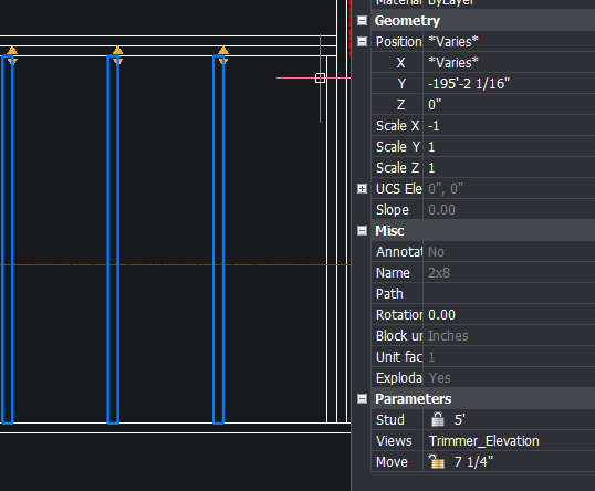

what I have is a parametric block with a stretch parameter called "Stud" I place it in multiple locations. I should be able to (Or want to be able to) select several instances of the block, and in the properties panel change the stretch "Stud" dimension. Is this possible?
Bricscad lite, 2D drafting, version 25.2.09

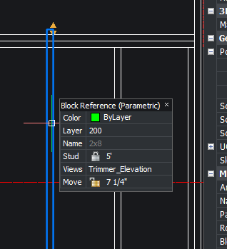

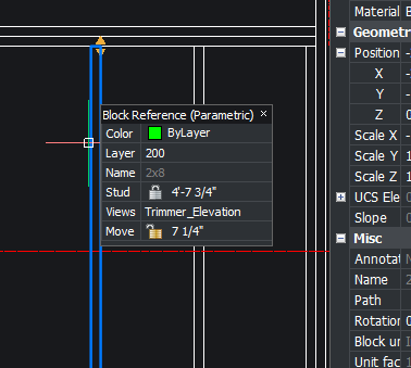

I see it has a lock next to it, but same with new instance.
If I do it with a single instance it works from the block reference popup, but not with the properties panel. The block reference popup will not allow changing more then one instance at a time.

I experience the same issue when trying to change parameter value from properties panel. It is possible via Rollovertips but it works only for one instance.

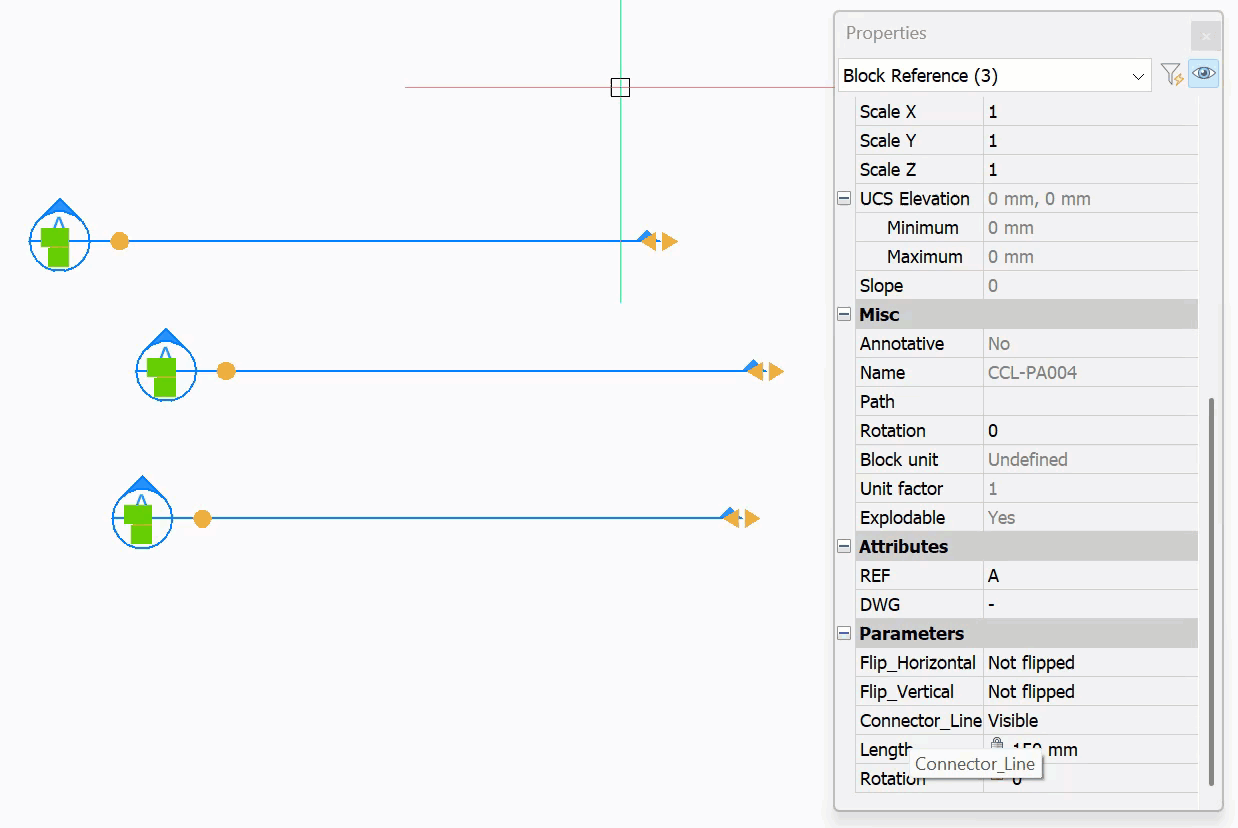

I did a quick check with some AutoCAD Dynamic Blocks & BricsCAD Parametric Blocks that I have created and I could modify their properties from the property panel.
With BricsCAD Parametric blocks you can use the -BMPARAMETERS command to update their parameters from the command line.
This command won't work with AutoCAD Dynamic Blocks. As Daniel suggested you can use SetPropertyValue to update them via LISP.

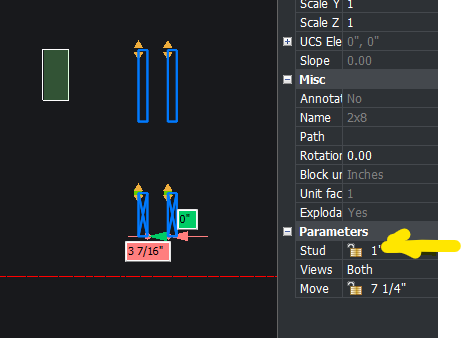

- -BMPARAMETERS shows Pro license only, BUT… @Jason Bourhill thank you, tried again today, same file but re-named, shut down program and re-started, now changing the value on multiple blocks worked in the properties panel just like your example. Go figure. Thanks again everyone! Finish up my project and learn some lisp next week…
