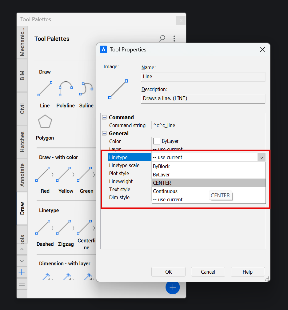

    You could try using the Tool Palette. This allows you to set the properties of commands

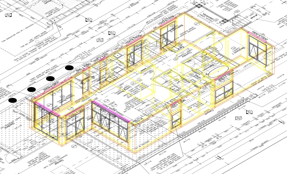

  • This image is auto layered you draw objects not lines. Think walls, doors windows etc.All go on correct layers with no user input.
