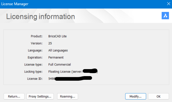

BricsCAD always reverts to old licence "lite" version
We recently got a new AWS cloud instance for a licence server, however my "lite" version of bricscad 25.2.09 won't recognise it. After I update the settings in the license manager and restart it keeps going back to the lite version. We also have a local server, and it appears to keep going to that despite me entering a new server many times.
I have tried returning the license and entering the server details - didn't work.
Tried loading bricscad using administrator. Didn't work.
Tried "C:\Program Files\Bricsys\BricsCAD V25 en_US\lictool.exe" with the correct credentials and it created a new .lic file - however it was identical to the old one that was already there.
I also searched the windows registry for anything of note (however I don't know what to look for).

  • haha sorry ignore my post I just fixed it.
    it was reading the old BricsCADV22.lic file that still was there. Deleting it fixed the problem and now it reads the 25 version.
