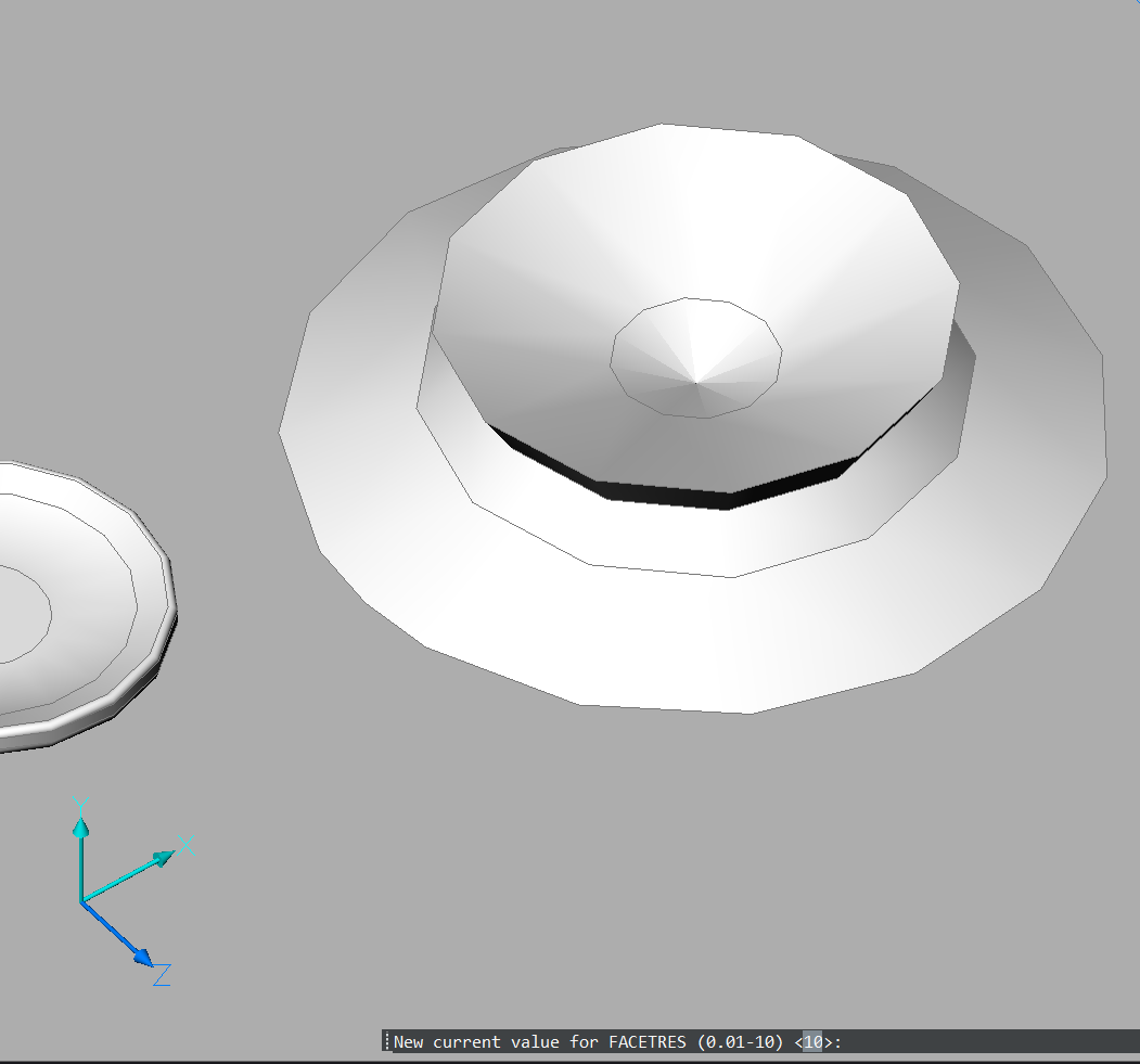

Low resolution of revolve

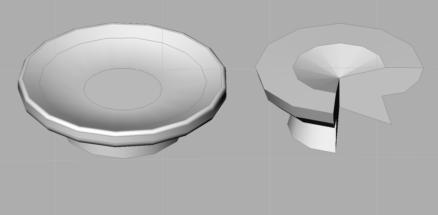

Why resolution of revolve with my model is so ugly please? Export to 3D printer is the same. Thanks
Comments
  • I tried this, this is facetres 10 before revolve

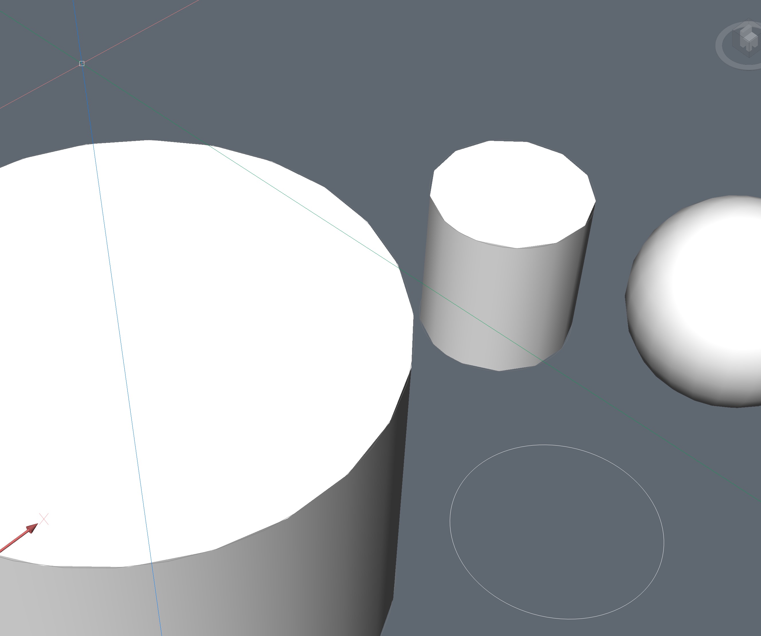

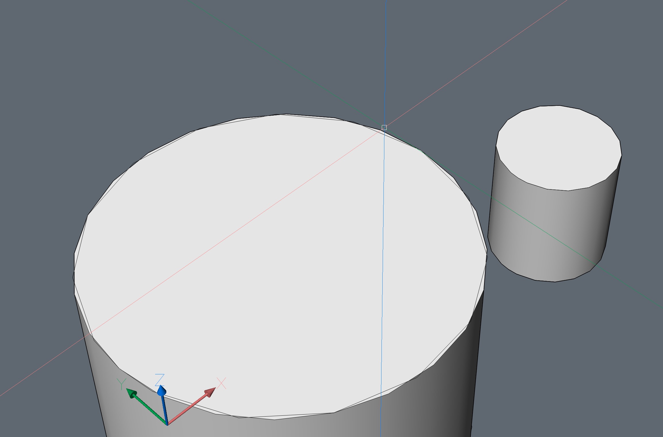

    OK, it is "partly" FACETRES setting - which defaulted to 0.5 here !
    So I set it to "2"
    Now I see that my Cylinder sides look better.
    But unfortunately the circular Top and Bottom Faces of the Cylinder are still a coarse 12 vertices Polygon.
    What you will notice even more, as now there appears a nice Circle along the Top Polygon.
    (Which I think is the of the Face of the Cylinder Wall sticking through)
    EDIT :
    No Circle - also a Polygon - both do just not match, slightly rotated.

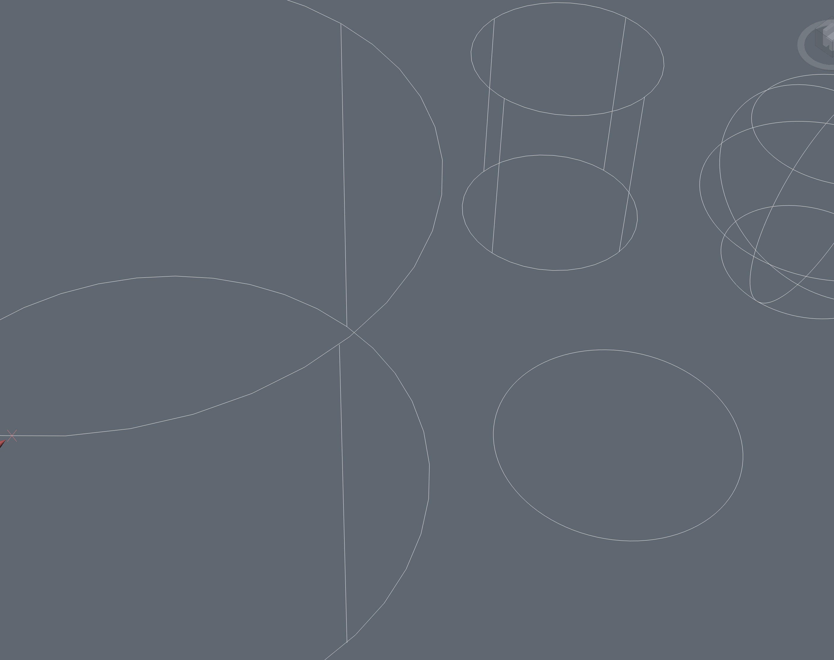

    The 2D Wireframe Mode Display Mode is good, but everything 3D Shaded (RedSDK) looks crappy, even 3D Wireframe Mode

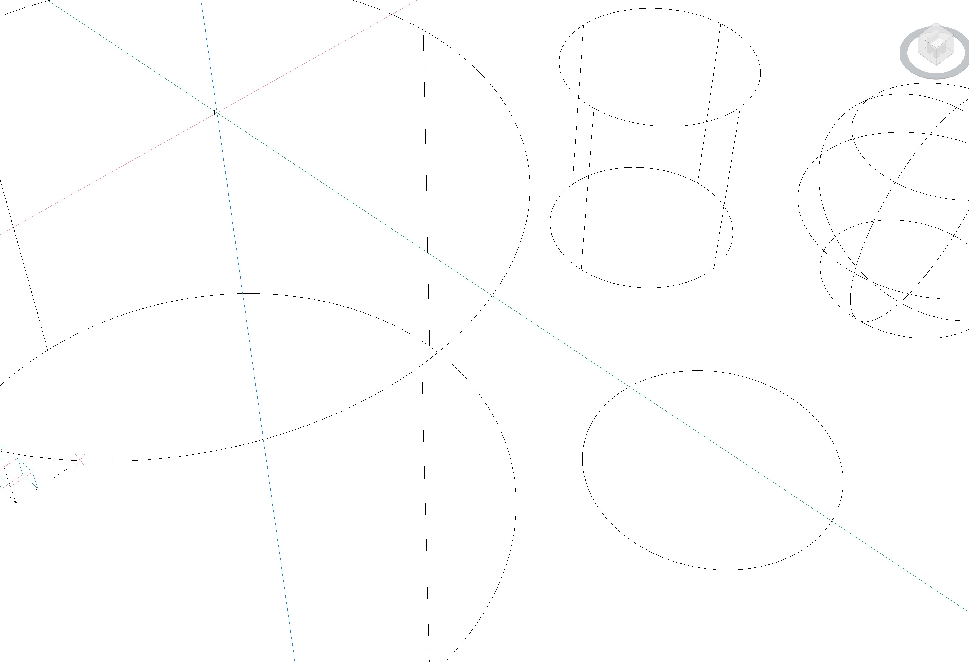

    2D Wireframe OK :
    3D Wireframe bad :
    3D Modelling bad :

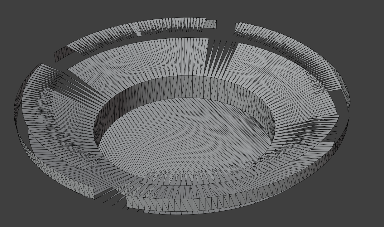

  • Miroslav Helebrandt
    edited December 2025

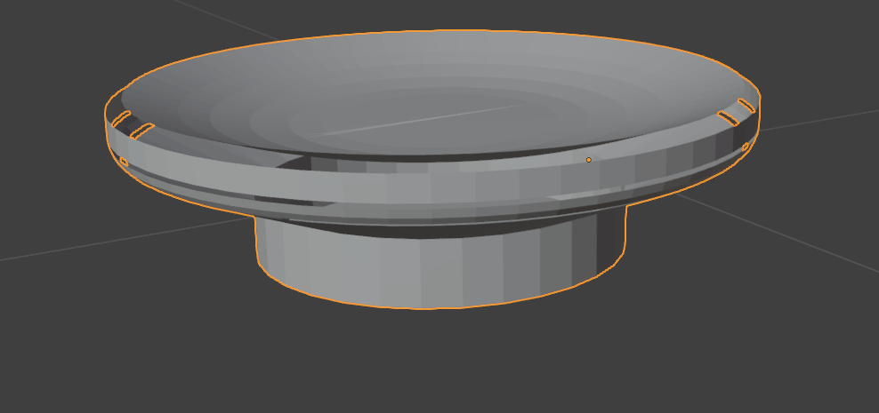

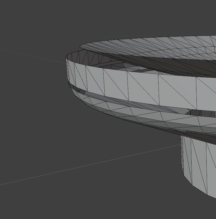

    Exported Stl in Blender looks like this, it is completely wrong. I generally use Blender to make my 3D models for printing , now I try to switch to Bricscad, but I am surprised as I am not able to make easy things.

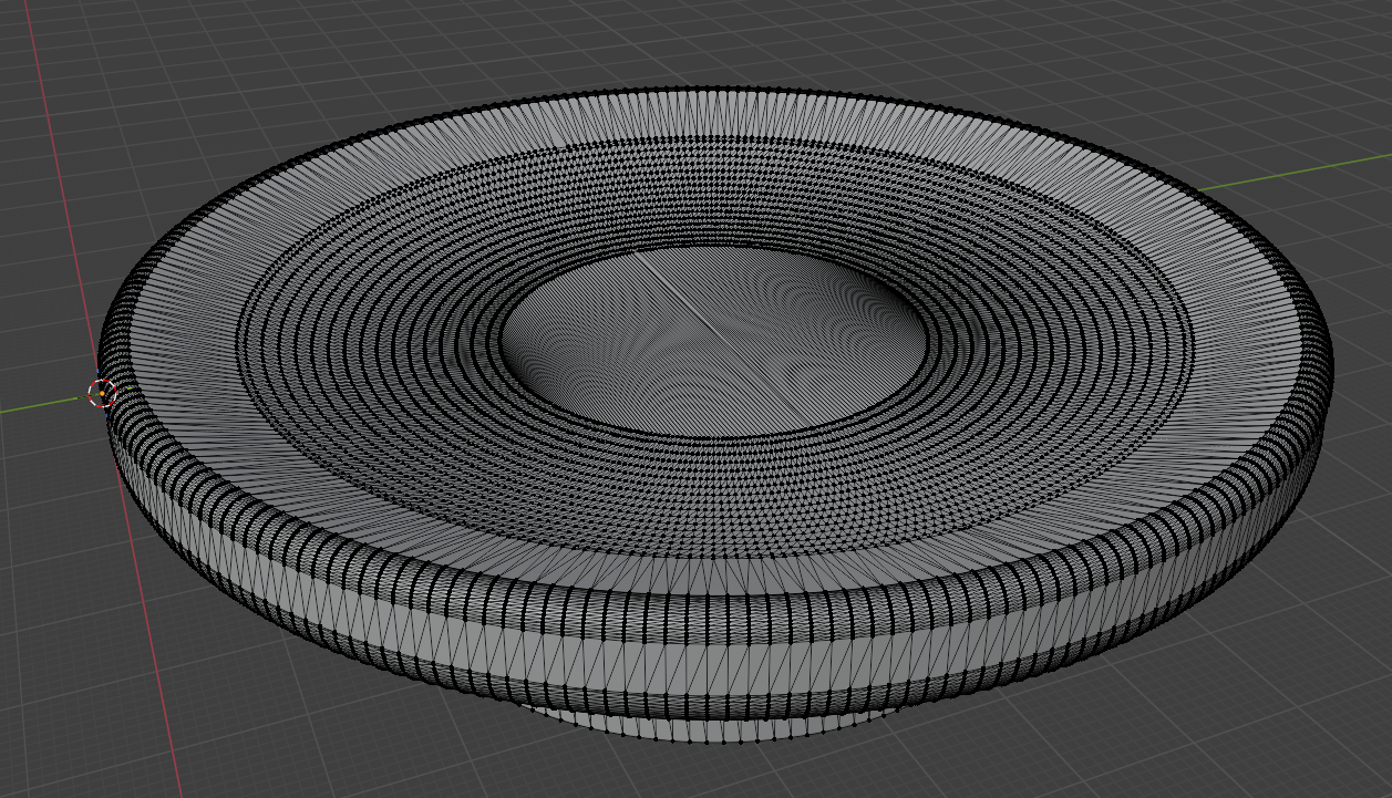

  • Hello, thanks for answer,
    but I am still not able to export my easy model od soap holder to 3d Printer slicer.
    Why it is so difficult to make this truly easy thing? In Blender it is done in 5 minutes without mistakes.
    With facetres 8 is STL result absolutely bad. After one week trying...
    I think such kind od easy model should work immediately. It is worth trying to continue? Thanks
  • The issue looks to be that you have generated your model in metres. This is effecting the resolution of the generated STL file.
    I scaled your model up by a 1000 and change the UNITS to mm. Following this STLOUT on high resolution gave a good result.
