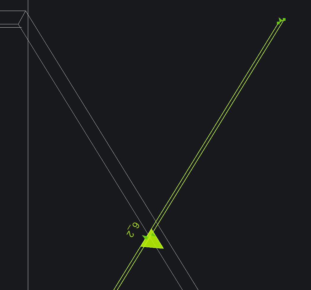

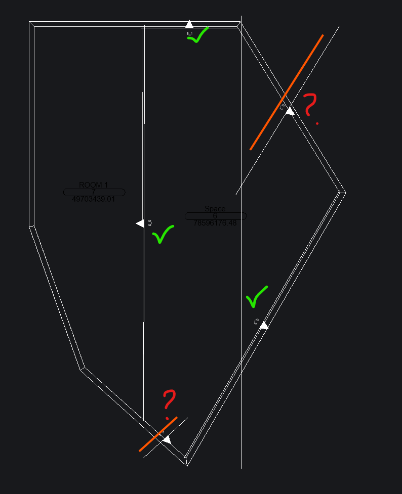

I am experimenting with interior elevations on a non orthogonal room generated from a BIM SPACE: I activate the bimsection command, select interior elevation and selecte the BIM space.
Question 1: Strangely 3 elevations are generated correctly but 2 are misaligned for some reason.
If I select the sections I see the planes are all skewed for some reason:
can you pls advise why ?
