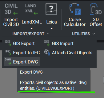

Hi, since installing v26 I am experiencing a problem with DWG export. It just does not work or works only sometimes. Even creating a simple 3P and trying to export it wont work. But it does export quite a complex drawing with point cloud, terrain, etc… I am attaching a video to show how I can import some Civil Points, save the file and so far so good. Then I hit export to DWG and it wont create the file and Civil Points will be modified (center point added and point circle becomes a polygon. It seems to be a bug as I just ran a full cleanup prior to installing V26…

Hi Jose,
I think you just use a wrong command, if you want to export DWG to some other format. The tool you are using in the video, runs the CIVILDWGEXPORT command, it exports the Civil entities to native CAD entities in the same drawing.
