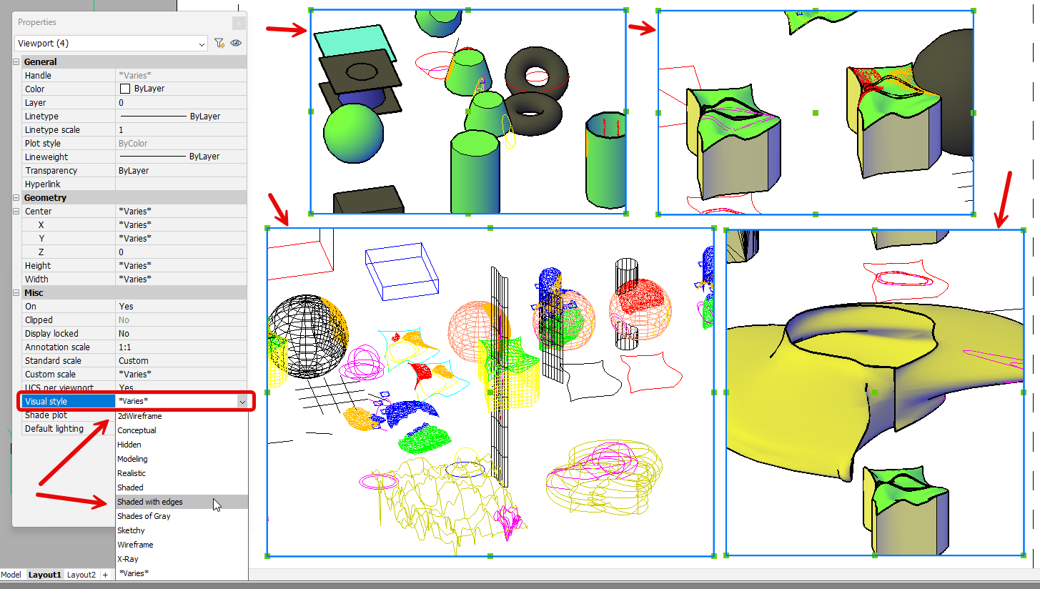

for Model Space Viewports have a look at
0 -
Use the following Lisp code for PaperSpace Viewports :
(defun c:changeVisualSTL_VP_PS ( / i vStyle vportsPS vpps)
(setq vStyle (getint "Enter a number for VisualStyle 1 for Wirframe, 7 for Shaded with Edges :" )
i 0
(print "Select Paperspace ViewPorts :" )
(setq vportsPS (ssget '((0 . "VIEWPORT"))))(while (< i (sslength vportsPS))
(setq vpps (vlax-ename->vla-object (ssname vportsPS i) ))
(vlax-put-property vpps "VisualStyle" vStyle)
(setq i (1+ i))
)1 -
