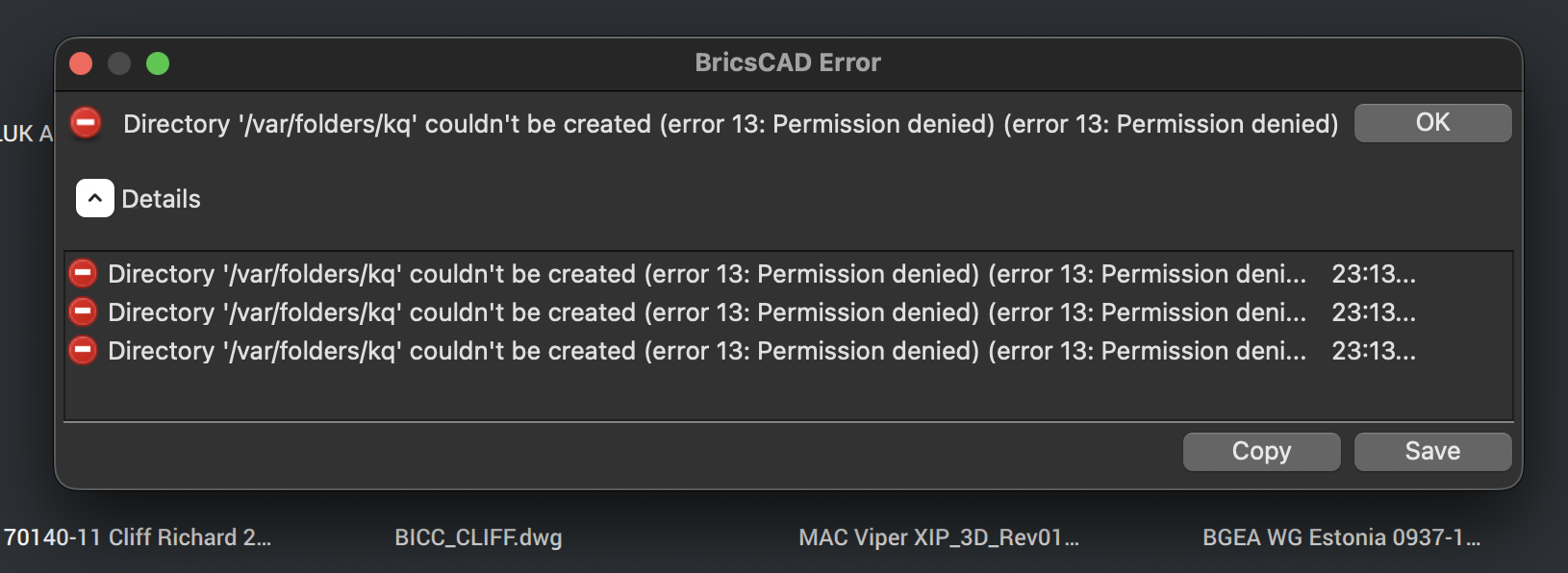

I'm running BricsCAD 26.1.06 on MOX OSX 26.2
When I open any drawing, I get the following error:
/var/folders/kq couldn't be created…
Can anyone help me with this one…

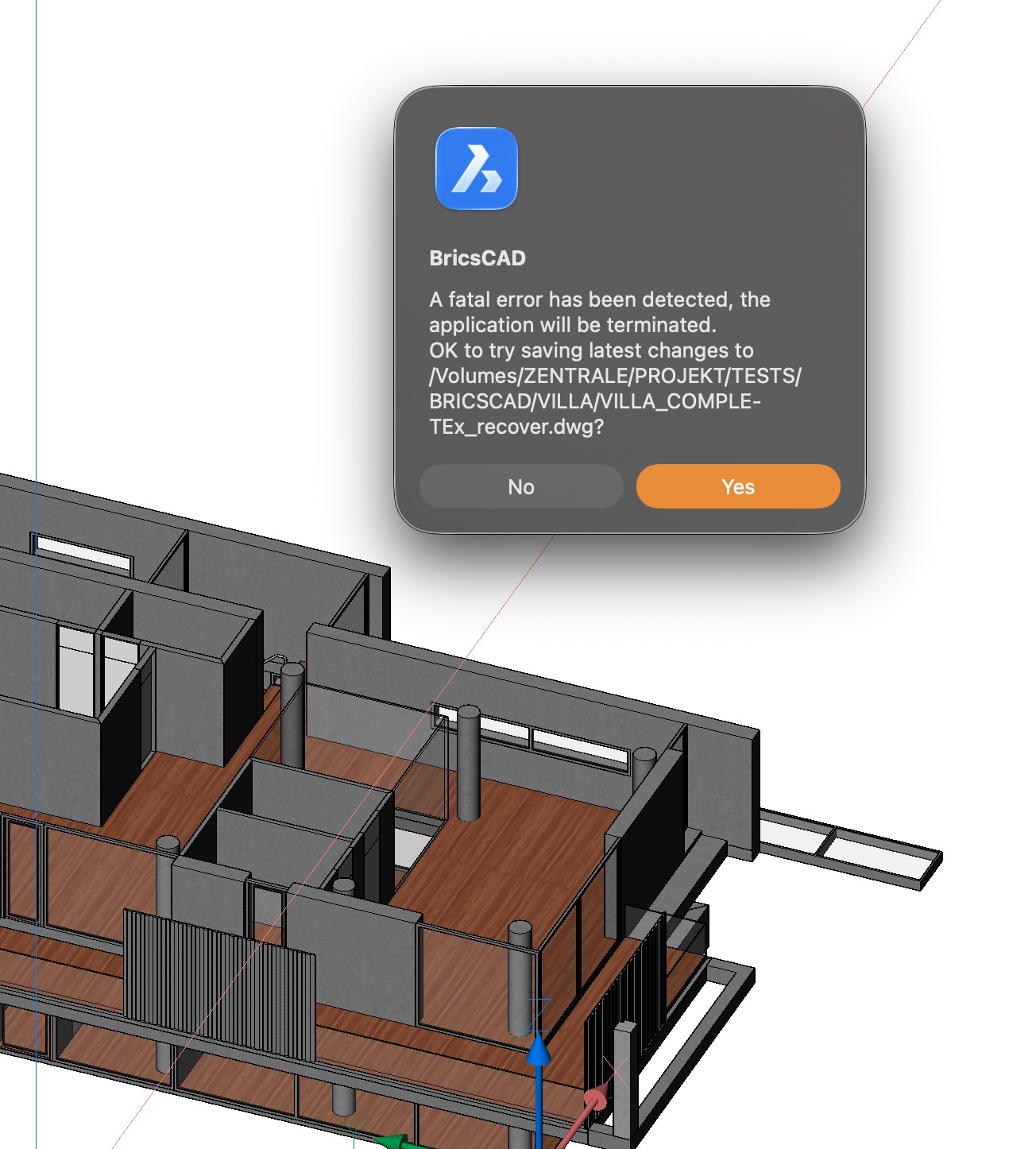

    I can't save existing (!) Files, neither on a network drive nor local.

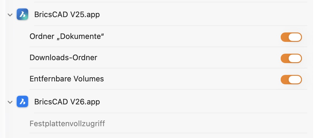

    Also the permissions seem to not work. While all Apps ask for permission when accessing any kind of drive, V26 somehow does not. It will not even be able to when getting full disk rights. If I disable full disk access, you will see that V26 only asked for User/Documents folder.
    But there is no real sense behind that Settings and V26's behavior anyway.
    Do you see any strange or missing settings in Apple Settings, Privacy and Security, for Files and Folders ?
