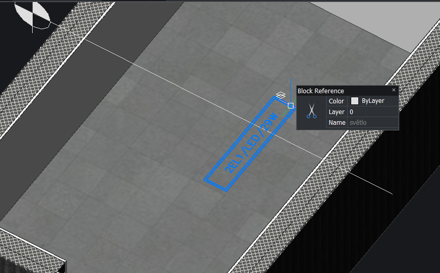

To make 2D entities visible in generated drawing, you can place them on a new layer named BRX_2D+_ and ensure that they are included to the block.
In this article you can find more details about BRX_2D+_ layer:
2 -
What does it mean "ensure that they are included to the block". My 2D entities are independent on any blocks. They are just as notes and comments.
1 -
They need to be combined to a block, separate 2d entities will not processed. E.g. on my printscreen text and polylines are included to block to be displayed in the generated drawing.
