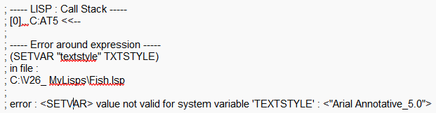

  • Hi Keef,
    This is the error I was getting when I tried to just drop your lisp into my drawing.
    i didn't have your textstyles in my drawing, so added the style and the routine worked.
    I tried APPLOAD, restarted Bricscad and it was still ticked when I started it again.
    I deleted it from APPLOAD and changed the text style to Standard in your lisp, which is in my template file and added it to my on_doc_load.lsp and it also worked no problem.
    Hope that helps?
