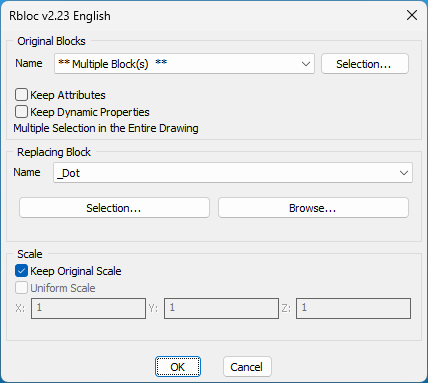

I'd like to have it ignore the current UCS, so maybe a check box in the DCL could work:
Use current UCS (unchecked will ignore UCS and use WCS)
or could be the opposite check box:
Use WCS (unchecked uses UCS)
Reason is, when replacing blocks with a UCS set, the replaced blocks go flying out in space, user has to undo go back to the WCS re run and replace the blocks, kind inconvenient in 3D space.

  • Hello.
    In my testing, the original script worked fine with a simple case.
    If using WCS is required, you could experiment with leaving the script as its author created it and embed it inside another script.
    Something like this:
    <pre>
    ; set wcs
    (command "_ucs" "_w")
    ; call rbloc
    (c:rbloc)
    ; wait for c:rbloc to finish
    (while (/= 0 (getvar 'cmdactive)) (command pause))
    ; restore ucs
    (command "_ucs" "_p")
    </pre>
