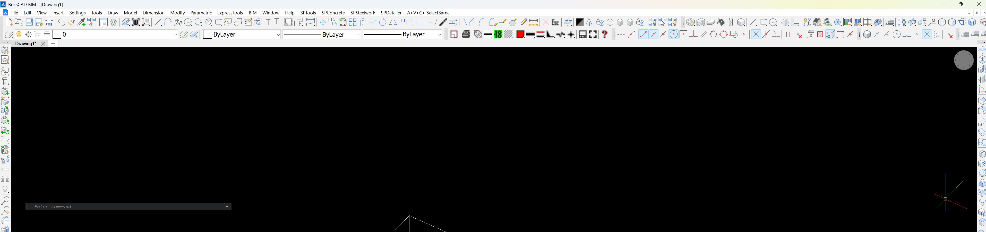

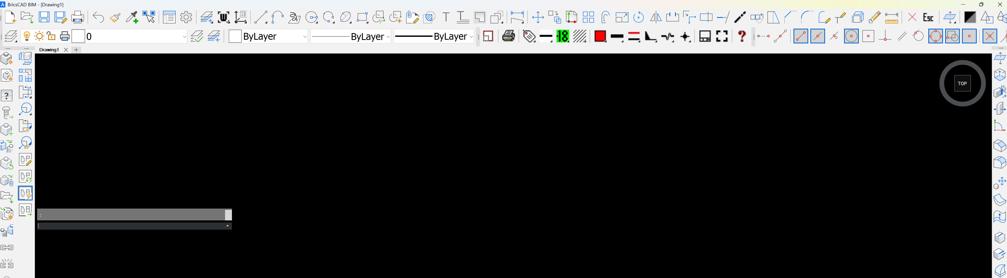

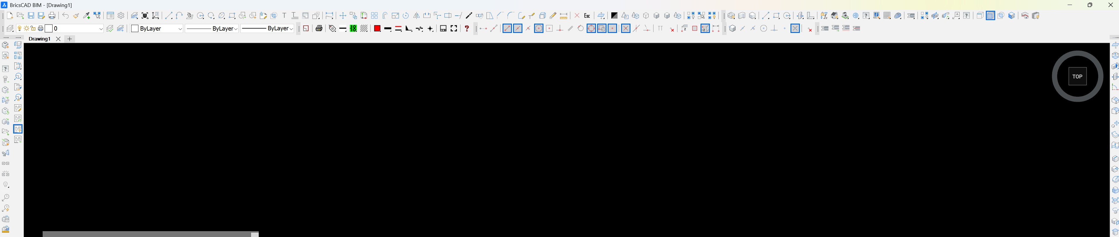

I upgraded to V25 from V20 and have found the icons on the toolbars are different sizes.
I have tried the different icon sizes from the dropdown but when set to small in V25&V26 they are to small and set to large they are to large. In V20 and V24 (currently using) they are set to large and all is good.
I have sent a support request and the answer was "try changing the screen resolution" which I found to be an unsatisfactory answer as will affect all the other windows applications.
All the icons are the correct sizes up to V24 and either to small or to large in V25 and V26.
Any thoughts? Perhaps something in the registry?
Images attached.
thanks in advance.
