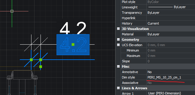

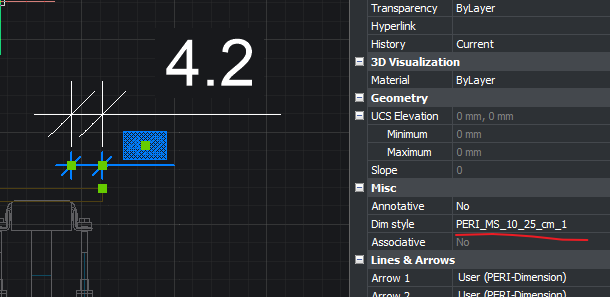

I want to apply user dimension style to every new dimension I've created. I recived a custom ObjectId dimension style and set it to DimensionStyle property of dimension inside using, BUT when I run the program result is confusing… Style is applied, but properties are completely different (pic 1). if I manually select any other dimension style in UI and select user defined style again everything becomes fine (pic 2).
How is that?
