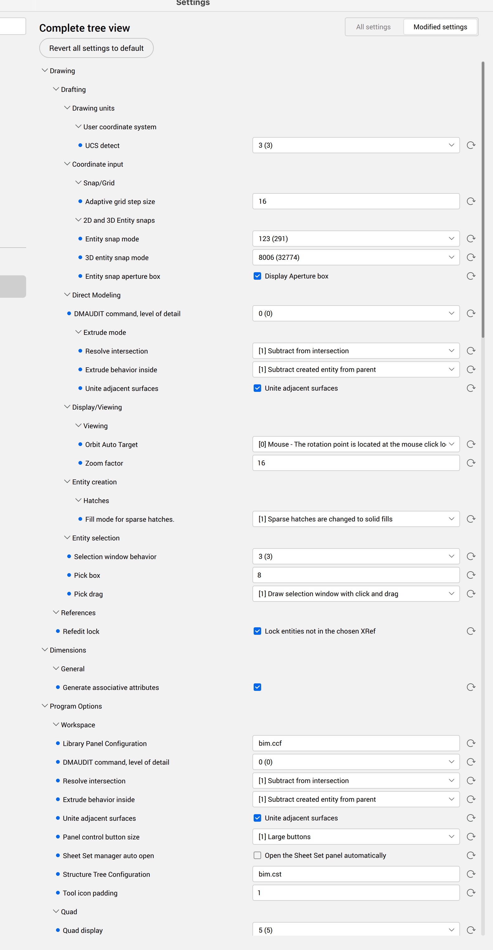

  • For me a clean Bricscad means changing 50-100 (?) Settings.
    Look at the scroll bar length …. which are only my modified settings :)
  • I know what you mean. That is exactly why I avoid doing most of this manually.
    What works for me is a small BricsCAD support folder, for example: /mnt/some/path/bricscad
    Add that folder to the BricsCAD support path, and put an on_doc_load.lsp there.
    Then I set most of my preferred variables from Lisp. A simplified example of on_doc_load.lsp:
    (setq vars '(
    (ANGBASE . 0.0)
    (ANGDIR . 0)
    (APBOX . 1)
    (APERTURE . 10)
    (COLORTHEME . 0)
    (DYNMODE . 0)
    (FILEDIA . 1)
    (HPNAME . "solid")
    (MENUBAR . 1)
    (OSMODE . 511)
    (PICKBOX . 10)
    (SAVETIME . 10)
    (TEXTSIZE . 2.5)
    (UCSDETECT . 0)
    (mapcar
    (function (lambda (dp) (setvar (car dp) (cdr dp))))
    vars)
    (setq vars nil)
    (princ)
    After that, a fresh BricsCAD install becomes much less painful.
    Modify to taste once, reuse forever :-)
