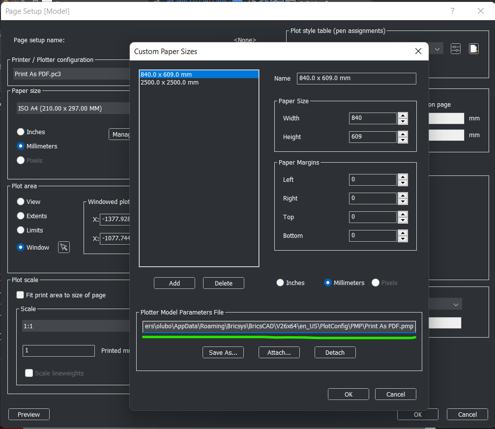

In BricsCAD 26, there's a problem with the "print_as_pdf.pc3" PDF file. The saved file doesn't work on another computer (it can't recognize paper sizes). Has anyone else had this problem? The file worked in older versions of the program.

  • If you set up some custom paper sizes, you also need to copy the file Print As PDF.pmp.
  • Dodaję w załączeniu plik który próbuję przenieść i wczytać na innym komputerze (zmieniłem rozszerzenie z .pmp na .txt aby dodać go jako załącznik na forum). Nie widzi go - oczywiście pamiętam o skopiowaniu go i dodaniu w oknie papierów
  • I unpacked the PMP structure and it is actually just zlib-compressed text data.
    See attached file. The custom paper sizes are stored there, together with references such as:
    C:\Users...\PlotConfig\PMP\Print As PDF2.pmp
    This confirms Lyubov's statement: copying only the PC3 is not sufficient when custom paper sizes are involved.
    The internal structure is more transparent than it first appears once decompressed.
  • Could you please attach the "print_as_pdf.pc3" also? I can use your pmp file in V26.2.04, I didn't replace the default file, but attach your file by 'Attach' button. Which version exactly do you use?
